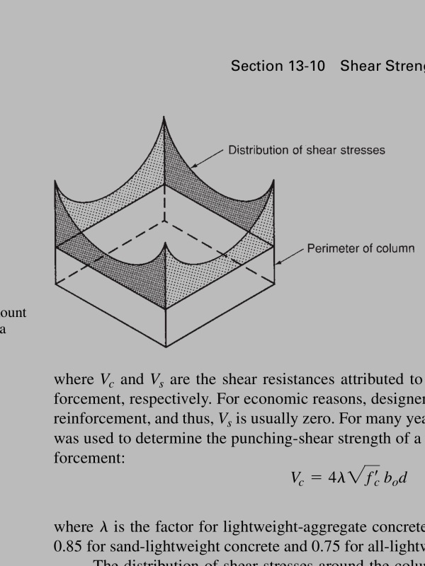

My biggest concern with this would be the impact on punching shear. You'll be helped by the fact that most of the punching shear stresses develop over the corners of the columns, pretty close to where your new bars will be.

To Kootk: your suggestions correspond well with what I had been thinking. I did not know though that most of the punching shear stresses will develop near the corners of the column. Is there any reference paper that I could read up on that? It is because I was worried about the punching shear stress that I was going to check it be another mechanism, namely interface shear and I am not sure why you are so negative about it. The interface shear transfer equations were developed by Dr. Loov with whom I have worked and for whom I have high regard. I do agree though that shear friction equations (as opposed to the interface shear equations) are difficult to use because there is no accepted means of measuring the surface roughness. I am not sure though that interface shear is a substitute for satisfying the punching shear stress, so you may have a point there.
I suppose it would be possible to check it by strut and tie modeling.
As hokie66 noted, I am still of course going to have to satisfy the code requirement that not less than 33% of the total negative moment be resisted by bars placed within the column width plus 1.5 times the slab plus drop thickness each side (1.5 x 10" = 15" each side of the column). That my be a challenge, but I have not got that far yet.
I wonder if there would be some merit in placing some top bars in the slab within the 30" column width and hooked at the column, even if I do not count on them for anything?

From Macgreggor's concrete text:

Very good Kootk. We have that in the office and I will look it up Monday. Very much appreciated.
