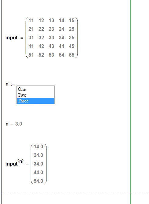

Not really clear that you're trying to do, but you can do something like:

Well,after some thought weather it's worth a more complicated solution at this moment, i've chosen to do exactly how IRstuff has shown.
Basically , every column represents a class with it's coresponding parameters. This is enclosed in a region i hide.
Edited the script for the ListBox just so i can add as many classes as i need.Didn't even bother with the fact that it will start showing results from the second row, since matrix col/row numbering starts from 0 in mathcad.I added an empty row for that. Since it's hidden, it doesn't have to be pretty, it just has to work.
call out the selected column (ctrl+6) and that's it.
