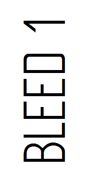

I want to add text to one of my drafts that is orientated vertically, in other words that the text is rotated 90 degrees from standard orientation. I've tried this with Text Box but I am unable to figure out how to do it. It's probably a very simple solution that I am completely overlooking, but I would really appreciate if some of you would have some insight. In text box properties I've tried to change the 'text orientation' parameter but this only gives orients the text vertically, it doesnt rotate the letters aswell. Please see the picture I've linked to understand what I mean. I basically want to rotate the text saying 'BLEED 1' 90 degrees.

Do you mean like this?

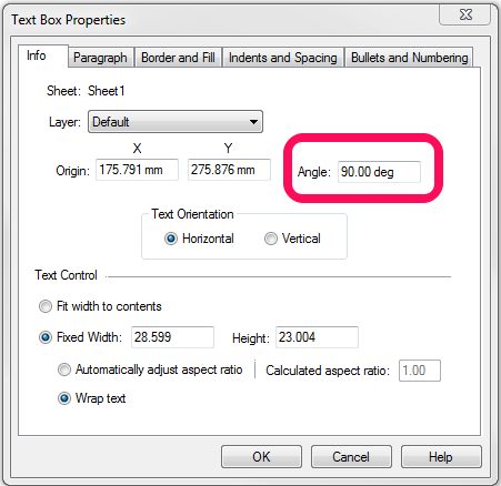

If this is what you were wanting, on the text box, right-click-> Properties and set the Angle to 90 or 270 degrees:
