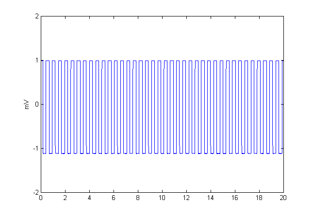

RE: Calibration of EEG device
Thanks VE1BLL!
I will try the voltage divider first because it is cheaper than an attenuator. The results will be updated for discussion.
Here is my test with 1mV input square-wave.
