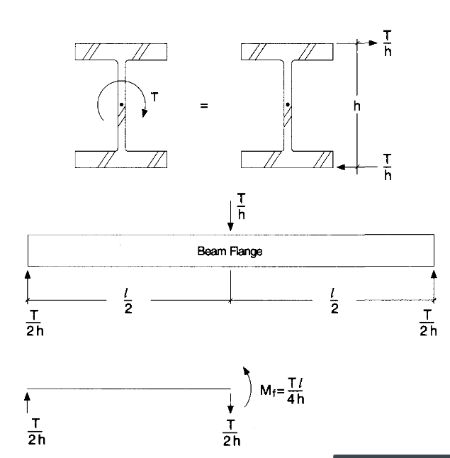

Rather than getting into a full torsional warping, I often point folks towards the Equivalent Tee method.
Essentially, you treat the torsion as a force couple applied to the top and bottom flanges of the I beam. Then analyze the tee beam to take the weak axis moment from that load.
It's simple in concept, it's conservative and it allows you to conceptually understand what those warping torsional stresses are really doing to your beam.
Nothing wrong with doing a full torsional warping calc with Phi and integrations and charts and such. But, if you lose the conceptual understanding and look at the issue instead as a exercise in mathematics, then I think you have lost something.

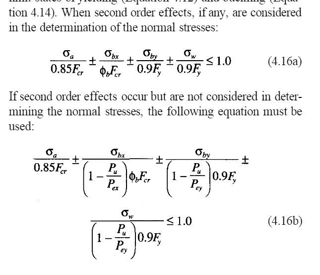

You should check AISC H3 (13th ed...not sure about 14th) for design checks. If you want to go real deep into it the torsion will add additional shear stresses at the extremities of the beam's cross-section. AISC has a design manual with lots of fun charts developed from diff. equations for different torsional fixity conditions allowing you to determine the shear stress based on J, G, maybe Cw, etc. I can't recall the design guide # but I think there's a free pdf online. I've had to go through the process for channel stringers and HSS perimeter beams where handrails were welded onto them thus cranking in torsion--which is a pretty common problem.
Also I think RISA can at least do the AISC H3 design check if you simply want to model it and move on.

So, JoshPlum, I googled the topic of equivalent T, first result was a link to this forum, where you give a procedure.
1) For torsion, think of the I beam as having been split at the center. Hence forming two Tee beams.
2) If the original beam was warping restrained at the ends, then your tee beam will be a fixed-fixed beam. If your original beam did NOT restrain warping, then your tee beams will be simply supported.
3) Break your torsional load into a force couple applied at the centroid of the Tee. Apply these point load or distributed load to each tee beam individually and analyze using simple beam theory.
4) The simple beam theory will develop weak axis bending moments (and flange bending stresses) in the Tee that are similar to the warping stresses that you'd get from a more rigorous analysis.

I don't think I have a worked example. What you do after you have an estimate of the warping stresses is a bit of an engineering judgment. But, at least you have some good theoretical understanding of what these stresses are and what their magnitudes will be.
Some folks will use AISC chapter H3.3. But, the problem with that section (IMHO) is that even a very small torsion immediately reduces the capacity of your section. That may work for a member that is primarily in torsion, but for a member that is primarily in bending it is problematic.
I prefer to use the following procedure (which I believe comes from Design Guide 9, though I can't remember exactly where. Convert the warping stresses into an equivalent weak axis moment that would produce the same extreme fiber stresses. This equivalent moment then gets added to your actual weak axis moment (since they produce the same sort of stresses). Then you use your regular chapter H equations for combing axial force, strong and weak axis moments to get a code check for the section.
There is also a shear stress aspect of it that should be checked as someone else already noted.
Someone mentioned that RISA checks WF for torsion and that's true. However, there are limitations and assumptions to RISA's treatment. It may be better than what the other guys are doing (STAAD, SAP, RAM), but RISA does have some limitations with warping. 1) RISA only considers warping stresses for beams with fixed ends (i.e. moment connections), 2) The fixed ends are always considered "torsionally fixed", so the solution may not be 100% accurate for a "torsional pinned" moment connection. 3) The stresses are calculated for loading consisten with DG-9 case 2, which is a constant torque.
My belief is that RISA's results will usually be conservative (which is why we chose the limitations the way we did). But, they are only exact for certain situations. So, I always encourage users to run their own simplified (i.e. equivalent Tee) hand calcs when torsion can be considered a significant design criteria for their beam.

I believe that Josh's Equivalent Tee method and my Bi-Moment method are one and the same. "Bi-moment method" seem to be more Googlable. I'm making up words all over the place. Basically, just follow the info pasted below, clipped from the AISC design guide that I linked above.
Quote (JoshPlum or BangerJoe)
I believe that the most theoretically correct locations for the force couple components are the Tee shear centers. Of course the shear centers, centroids, an top of top flanges (pic below) are more or less all at the same location for Tees. Using the centriod produces the most conservative result which, perhaps, is why you've taken that tack.

Good point KootK. The simplified method is supposed to always be conservative. That's why you can get away with moving the load out a bit further towards the center of the flange or the extreme fiber. I tend to forget about that because I'm not doing my own calcs very often.
Instead, I'm usually trying to teach the concept to engineers who are unfamiliar with the whole concept of warping in wide flanges. Just trying to get folks to understand in a physical sense where these stresses are coming from and approximately what the magnitudes are. Sometimes this is for our younger support engineers, other times for users who don't quite understand what the torsion results in RISA are telling them, or who are concerned about a warning message that RISA throws up when their loading doesn't match our case2 assumptions.
If I were doing my own calcs, I would probably dig in a little deeper and see how far apart I could stretch that force couple.
RE: Torsion in I beams
Also, (for what it's worth), I think those equations (from DG-9) are too conservative. To me, they're more like ASD 9th equations that haven't yet been adjusted for an LRFD / Strength level world.
