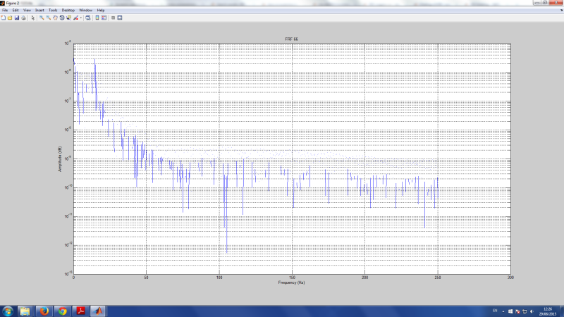

Hi everybody,
Can anyone comment my work, since I'm new in this are? I'm trying to perform SIMO analysis in MAtlab.
I have done an analysis of Euler-Bernouli beam subjected to square force in the middle of the beam in Matlab. Using Wilson's Theta numerical integration method I have calculated the beam response, e.g. accelerations, velocities and displacements for the applied excitation. Time step for calculation is 0.002sec. Load magnitude is 25kN and durations is 0.5 sec. The time sampling interval is 5 sec. The force is applied in the middle of the beam, what coincides with the 6th node.
Now I want to obtain point FRF. I know that FRF is the ratio of the beam response to applied loading, i.e. displacements to square force in frequency domain, but here are some unclarities how to obtain this in Matlab.
I'm not sure what should be the sampling frequency. Is it 1 over time step 0.002 for which I've calculated the beam response, or is it 1 over the time sampling interval of 5sec? I've used the time sampling interval, but I don't know is it correct.
Then, I have performed the fft of the displacements for the node where the load is acting and only for translational DOF. Fft of the force I've also done. The absolute values of both are calculated.
Here is the code which I have used for obtain the FRF's:

I have also attached the picture with the results of the beam response,
and picture of the FRF at node 6
Would it be reasonable to calculate the power spectral density with periodogram or welch method instead of doing just fft?
Can anybody comment my work, because I don't know is this exact, am I going in the right way?
Please help!

RE: Experimental Modal Analysis
"square force " - what is that?
"The time sampling interval is 5 sec" Bet it isn't, sample interval =1 /sampling frequeny, i think yoiu are talking about your frame length in seconds, hence you should have a resuolution of 0.2 seconds and a nyquist frequency of 1/.002/2=250 Hz
Do you understand Welch? If you do, great, use it.
If not then you are trusting somebody else's black box. Why not take the FT of the input signal and the output signal, and look at the complex ratio of them? That surely is the essence of a transfer function (even if computationally it is inefficient compared with welch), it can be checked for reasonableness, done by hand, and so on.
Cheers
Greg Locock

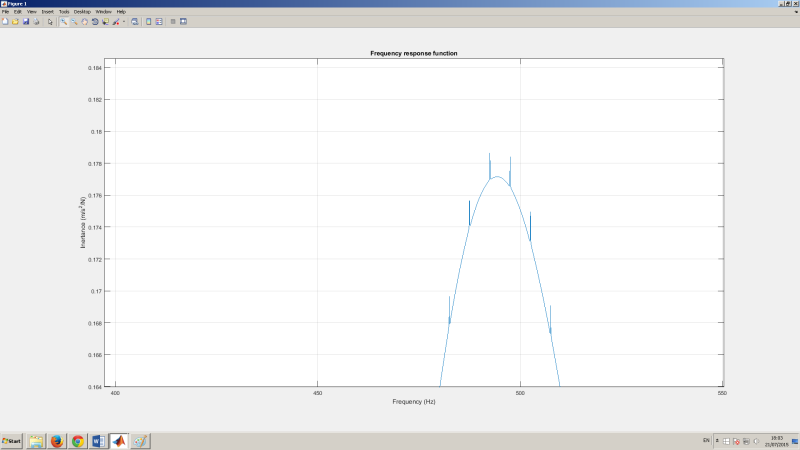

I have done the roving hammer method with eight impacts. Now my results show some sense what means that peaks of the FRF are visible and they correspond to values of natural frequencies. The values of first two peaks are almost identical to the first natural frequencies and they are tapered the most, the third peak value is also almost the same as the third natural frequency but the peak isn't that much tapered.
How can I make other peaks visible on my FRF curve? Should I apply greater force? Anny suggestions on this topic.
I have attached the final FRF curve which I obtained with calculating the ratio of auto power spectrum of output and cross power spectrum of the input and output using cpsd function in MATLAB with hanning window length equal to number of samples.
Also on my plot there are some anomalies. I have zoomed this on the following picture. Is this happening because of the type of window I used? Any suggestions how could I smooth the curve.
Comments and suggestions are welcome.
Many thanks!
Emina B.
As you can see, tapering decreases with peak number.
It means that the damping is certainly viscous or hysteretic.
You can try to verify for each peak if (Delta f)/f = Constant ( where f is the frequency of the peak and Delta f is the passband located at Ymax/sqrt(2) ).
