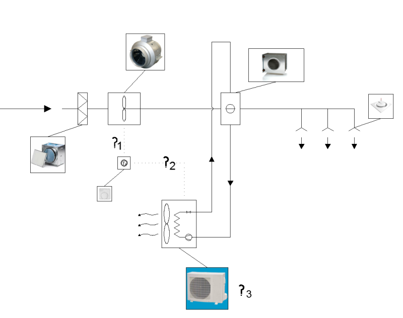

I have made a more self explanatory sketch for better understanding:
My doubts are at 1,2,3:
1: I suppose the fan should have some sort of connection for the on/off button to the controler. Do all have or might I just buy the wrong fan ?
2: I don't have a clue on how to connect the exterior unit with the temperature sensor such that the unit (aka compressor/unit fan/laminator) will turn off in tandem with the fresh air fan. Do I need a two conection sensor ?
3: Are there any exterior units to be baught without the interior split unit or must I buy a SH one and modify it myself ? What about the heating mode (reversed refrigeration cycle), can that be manually turned off so that the unit will work only on cooling ?
*4: Any alternatives cheaper/simpler than this are appreciated.

I just took the simplest route, which was cheap enough at wholesale prices. The prepackaged AHU came with the 24VAC transformer to power the thermostat loop, and a contactor to turn the fan on and off. Connecting it was a no brainer. Going off memory: three signal conductors ran from the thermostat to the AHU's controls and a pair of conductors ran from the AHU down to the compressor/condenser unit. I don't know if the AHU fan has a run feedback that determines when to tell the outdoor compressor/condenser that it's OK to turn on or not, but I do know that the t-stat has a "fan only" setting which allows you to run the fan without enabling the compressor/condenser.

No. The A/C system is what controls the inlet air temperature- by cooling the air in the room...you can't independently control it.
The outdoor unit will cycle on and off as the thermostat tells it to, unless you go for a variable speed unit, and frankly I'm not sure how those are controlled. The TXV will regulate refrigerant flow to the coil to maintain a certain amount of superheat in the vapour leaving the coil, which reduces the load on the compressor and saves energy relative to a plain orifice. Temperature control inside the house in a normal A/C system is on-off, using a simple switch-type thermostat.
The outdoor unit is always over-sized except for the peak demand (highest design differential temperature between indoor and outdoor) when it will run continuously. The key is to pick an indoor unit matched to the needs of our outdoor unit. You also need to pick an outdoor unit which doesn't have vastly more compressor/condenser capacity than you really need, otherwise it will "short cycle"- it will run only for brief periods and hence allow too few air exchanges over the coil before it shuts off again to do a decent job of dehumidification- and in my climate, humidity is the thing you really need to control to be comfortable. Most HVAC people over-size units because they think that will make owners happy- it will cool the house off from a peak temperature much faster of course, as well as handling the hottest day or two you encounter every year without allowing the temperature to rise much above setpoint- but then it will do a crappy job of maintaining temperature and humidity level for the entire rest of the year.

It all sounds rather complicated. The system I'm trying to build myself is very simple:
(0)outdoor
(1)-> main circular duct
(2)-> filter (round fittings)
(3)-> in-line axial fan (round fittings)
(4)-> cooling coil (round fittings) with two pipes going out of it (in-out for refrigerant)
(5)-> pipes go to exterior unit (basic heat pump cycle unit)
(6)-> adjustable air inlets for achieving confortable air speeds
(7)-> temperature controller
Each of these components is an individual object, no box, no premade stuff, just bought of alibaba or something.
Fitting them together with circular piping is easy.
More problemaic are:
(4) -> welding cooling coil pipes to exterior unit pipes (hire a specialist). Afraid of refrigerant spilling with time.
(5) -> couldn't find where to buy individual exterior unit from. thinking of buying a second hand one that comes with that interior split unit (which I don't need, throw that away)
(5) -> what kind of controller outputs/signals will such outdoor unit have ? can't seem to grasp how it works (automation-wise) and how can I connect it/modify it to a simple controller to fit my needs.
(7) -> simple analog thermostat which I turn and then the system goes full-blown with cold air. (haven't got this figured out without a sketch, again figuring out controllers)
I've calculated the cooling load so choosing the cooling coil and the exterior unit shouldn't be a problem (7.5 kW/24000 btu for both the capacity of the coil and exterior unit since pipe heat losses are neglijable)
