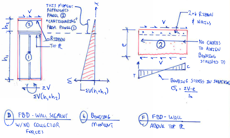

I don't dispute any of the constructability stuff. I agree 100%. There is, however, still a minor technical hiccup to consider.
With the detail as you've proposed it, the plywood will be forced to cantilever above the top plates to pick up the shear load. The cantilever distance would be the vertical height between the double top plates and the nails connecting the wall sheathing to the rim board. This cantilevering would result in in-plane bending in your wall sheathing.
Is it a big deal to have your wall sheathing cantilever up a foot or so to pick up the shear load? Surely not. However, we don't normally subject sheathing to in-plane bending when we're doing a "by the book", Malone style lateral design. Rather, we stick to the "shear panel" assumption and insist that all flexure be resisted by discrete chord members.

I guess I don't see any "cantilever" action here. The shear from the diaphragm is simply transferred into the rim board and the shear in the rim board is transferred into the vertical sheathing.
The double top plate and the rim board do not "support" the sheathing - rather they are simply elements used for connectivity and they just go along for the ride.
For the sheathing to "cantilever" that suggests that the double top plate is some kind of boundary condition for the sheathing, which it is not. There is no finger of God here pushing back on the double top plate resisting lateral movement such that the sheathing will bend like a cantilever in plane. The sheathing is what is securing the double top plate from moving laterally.
I would agree also that the so-called bending, if it even exists, is not really significant anyway.

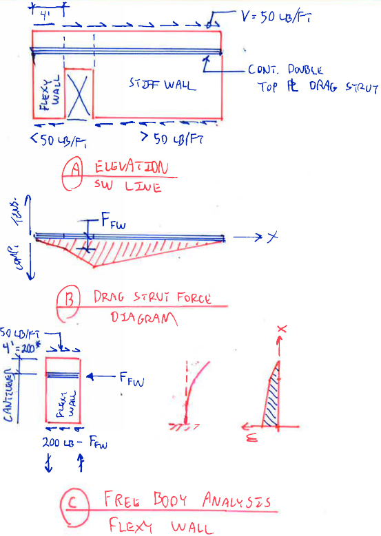

See below. I don't go isometric for just anyone you know. I think that the mechanics are more apparent if one considers the floor truss / top ribbon scenario where this often comes up. It removes the appeal of the strut and tie mechanism that I mentioned above.
Quote (JAE)
The ubiquitous case is that of shear walls that do not run the full length of the roof diaphragm (mike20793`s point above). In that scenario the "hand of god" is just the restraint provided to the top plate by shear walls further down the line. As a particularly salient example, consider the sketch below as it might occur over top of a window opening.

No doubt. I really just tabled this as a possible explanation for why you never see details like this proposed in the industry literature. I also find that there is relatively little awareness of the "shear only diaphragm panel" concept that underpins virtually all diaphragm design in wood.
Were there to be a real problem, I suspect that it would be with the fasteners rather than the sheathing. The moment induces additional local nail shears not accounted for in the typical diaphragm design where we just pluck some handy unit shear numbers from the stock tables.

Without the chords, the flexural tension and compression forces that would have otherwise resided in them have to be transferred across the sheathing panel to panel joints that are normally designed to transfer only shear. That means:
1) [Shear + Tension] AND [Shear + Compression] interaction forces on nails usually design just for shear.
2) Compression needing to be transferred from panel to panel across joints that usually include a 3 mm gap.
3) Tension forces needing to be transferred from panel to panel across joints where the nails are very close to the edge of the sheathing and the edge of the supporting framing.
Again, this is just theoretical sport on my end. I don't really think that your detail is in any trouble.

Sorry KootK - I don't buy your iso drawing. You show a SumV value where there is none.
The double top plate has no way to create a Sum V force as it is simply a loose double top plate attached to the sheathing itself.
I could draw a free body diagram of the full height sheathing (bottom of wall to top of rim board) and have a complete static condition without the "cantilever" action you are attempting to show. Simply sheathing in pure shear from top to bottom.
Again - for there to be a cantilever with a cantilever span of "e" per your diagram the double top plate must have something (finger of God) holding it from moving laterally and there isn't anything but the sheathing. But the sheathing cannot cause its own moment.

Quote (JAE)
Jeez... I was wearing braces the last time that I got three red exes on a single page assignment. My kids loved this and request more of the same.
I muddied the waters in my original sketch when I indicated that the collector force in the top plate would be SUM(v). In general, it will not be SUM(v). Rather, the collector force could take on just about any value, positive or negative, depending on the relative stiffness of the various vertical bracing elements up and down the line. See sketches A, B, and C below for an example of a case that would yield a shear flow diagram consistent with my original sketch.
The "finger of god" force is really a red herring when it comes to this debate however. The statics of the cantilevered sheathing above the top plate remain the same regardless of the value of the top plate collector force. See sketches D, E, and F below for the statics when there is no divinity at play. Panel two just cantilevers from panel one, without the benefit of discrete chords.
RE: Wood Diaphragm to Wood Shearwall Anchorage
So the whole shear wall is a cantilever off the footing.
I'm not sure why then there is any concern over a small portion of that "cantilever" up at the top.
Your earlier statement "a minor technical hiccup to consider" concerning this cantilever isn't a hiccup at all - simply a feature of any typical shear wall, correct?

Quote (JAE)
There is no real concern on my part. I tabled this as an explanation for why we don't see details like Jerehmy has proposed in the literature.
Quote (JAE)
Not in my opinion. The unique feature here, in my mind, is that the upper portion of the shear wall doesn't have vertical "chords". That means that flexure has to, briefly, be resisted by bending stress in the sheathing. The design methodology that we generally use for wood diaphragms assumes that sheathing is only loaded in shear. This issue doesn't develop with typical detailing where blocking or rim board acts as a mini-diaphragm to transfer shear from the roof diaphragm to the shear wall top plates.
I don't feel ambitious enough to dig up the clause references but both the US and Canadian wood design codes contain language to the tune of "all wood diaphragms shall have discrete boundary elements on all sides". This is an expression of the "shear only panel" assumption built into our standard wood diaphragm design methods. Technically, Jerehmy's detail could be construed to be in violation of these clauses. I'm not, for a second, suggesting that anybody over at the AHJ is going to flag this however.
