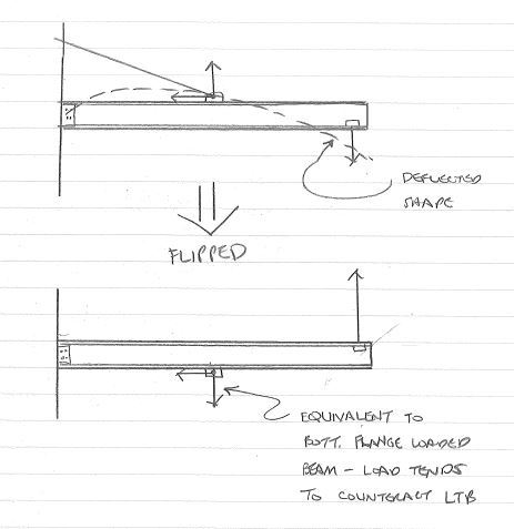

RE: Wall Mounted Jib Crane Compression Member Effective Length Factor k should it be 1 or 2
I guess I'm thinking that the Lb for LTB is L1 + L2. If you turn the horizontal beam upside down you essentially have a bottom flange loaed simple span beam.
If the beam tries to laterally buckle (i.e. lay over sideways) the imposed loads on the opposite flanges would resist that rotation.
For the column KL/r I'll have to think about that a bit. If you use 2 x (L2) I think you'd be safe. I'm just not sure if something less than that can be justified.
I'd think there's be some literature out there on jib beam designs.
I also think your vertical plane deflected diagram is wrong. The downward deflection of the beam between column and tie-rod connection should be upward - full negative moment along the full length unless your beam weight is enormous.
Thank you JAE, BOPECO and Kootk! I really appreciate the discussion that we are involved in.
How can lateral torsional buckling occur when the lateral deflection as you guys say does not occur. As you suggested that the beam will simply rotate and the beam will not bend in weak axis. If that is the case in order the lateral torsional buckling to occur. Three conditions need to occur.
1) beam must deflect or move in the load direction ( happens in this case, and generates moment at tie back rod location)
2) Beam must move laterally or move perpendicular to its cross section ( the beam is connected to pivot shaft, therefore no restraint provided in lateral direction @Kootk what do you think)
3) beam must twist about its longitudinal axis ( the load at the tip of cantilever stabilizes the bottom compression flange and the tie back rod is restrains the tension flange (stabilizing beam)).
@ JAE - if you flip the beam the load would be in opposite direction
I will post a detail sketch lateral so that it could assist you as to what I am thinking.
Best Regards and once again thanks for the discussion!
Here's the flipped sketch of the beam.
Quote (Deension)
It's best to think of the movement as a rotation about a point in space lying on the same vertical axis as the beam shear centre. Technically, this would be constrained axis buckling (Google that for fun) as the beam would be forced to rotate about the top flange connection to the tie rod.
LTB buckling is definitely a possibility here. It's quite analogous to the argument that I used for the weak axis buckling. An LTB buckling mode involving swing about the hinge is meaningless because it represents rigid body rotation. You will, however, have to contend with an LTB mode where both the hinge and the tie rod connection represent lateral restraints. The hinge will be a lateral torsional restraint. The tie rod connection, while not a lateral restraint in general, would be considered a pseudo lateral restraint for the sake of the LTB mode buckling check. This is just like how, for weak axis compression buckling, the tie rod connection would be considered a pseudo lateral restraint to produce the K=1 buckling mode. Whether or not the tie rod connection represents a torsional beam restraint for LTB is another matter and is the crux of the discrepancy between my and JAE's estimates of effective LTB unbraced length.
Quote (Deension)
As I mentioned above, twist will technically be constrained to occur about the top flange where it meets the tie rod. Minor point. Whether or not the load effectively prevents beam rotation at the tip is a matter of considerable interest and is the source of the discrepancy between my recommendation regarding KL_LTB and JAE's recommendation. If the load can be relied upon to provide rotational restraint, then JAE is correct and the upside down simple span beam analogy would be appropriate. If not, then KL would be something longer than that analogy would indicate. For what it's worth, I suspect that, in most practical applications, the load would provide sufficient restraint. I'm just hesitant to assume that without quantifying it somehow.
