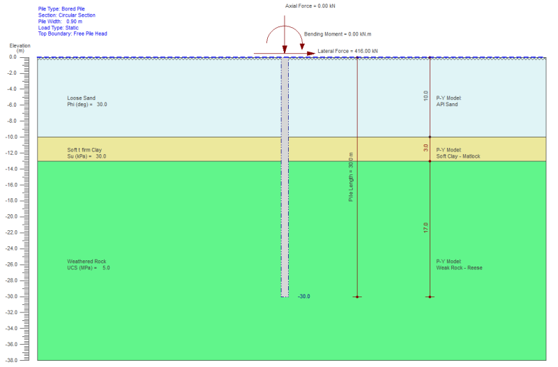

I calculated the load. The load acting on the pile is 416 kN and at about 1m below the pile top. Pile is a 900mm pile embedded in to fractured rock of about a 30m total length. Water table is at the same level of the prop (1m below piile top). I'm looking in to Bowles' method but it's a bit conservative.

Based on your information, the ground profile and the loads are roughly shown in the figure below:

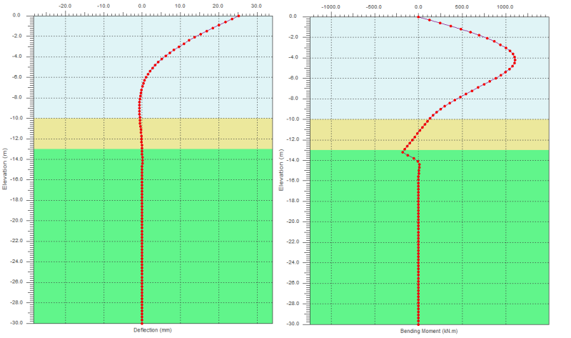

The pile deflection and bending moment would look like this:

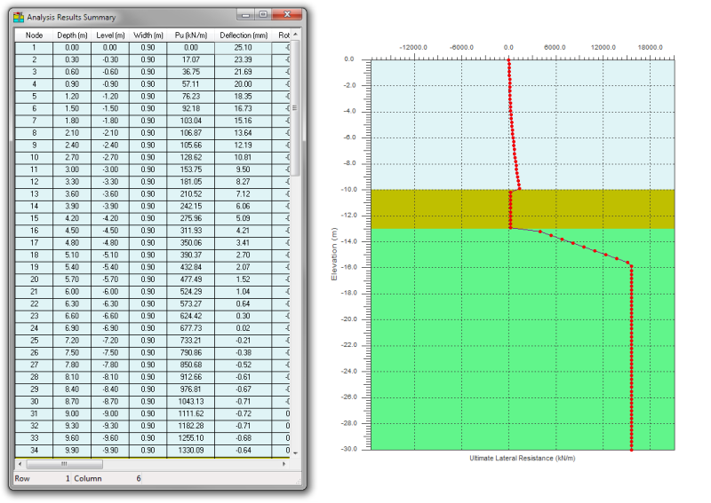

The p-y curves along the pile length within the loose sand layer are:
This just gives you some feelings about the p-y curves along the pile.

Low shear force at the pile head doesn't necessarily mean that the resulted maximum bending moment will be low. More importantly, it depends on the soil stiffness around the pile, especially the top 10 m thick loose sand layer for this case. If the stiffness was very low, even a small shear force at the pile head can lead to a large bending moment in the pile.
The results I attached in my previous reply are obtained with adopting API sand model for the top loose sand with the water table at the layer top (I used the program of PileLAT 2014). The maximum bending moment is about 1100 kN.m. Noted that if the API sand model is replaced with Reese sand model (just using different p-y models for the top sand layer), then the maximum bending moment resulted is about 1210 kN.m. I also used LPILE program to double check the results and the maximum bending moment from LPILE is 1211 kN.m.

Thanks for your discussion and I think you may overestimate the ultimate lateral resistance of the loose sand layer and this is the reason why the bending moment and deflection from your analyses are significantly less than what we predicted. The ultimate lateral resistance of the loose sand layer depends on the friction angle and effective overburden stress.
Therefore, it would starts from 0 at the layer top (effective overburden stress is zero) and generally increases with the depth. The lateral resistance distribution from your analyses appears constant with the depth within the top 10 m sand layer. For me, it seems that it has been treated as a cohesive soil layer. Results from my analysis are attached below.
For the same reason, the actual spring stiffness around the pile within the sand layer also should start as very small value at the layer top and then increases with the depth in the similar pattern as the ultimate lateral resistance. Note that the pile lateral analysis is sensitive to the spring values close to the pile top.

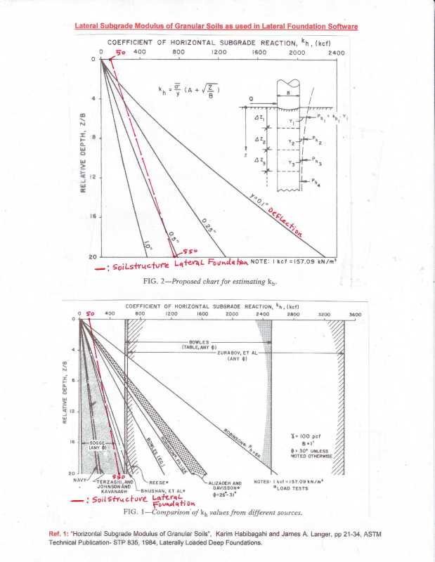

Not sure if we can close the 200% or so gap that exists between us, but I will give a last try. I did a third check using Teng's method of granular soils and came up with 630 kN-m max. moment (see attached). So it seems that 400 to 600 kN-m is what I have found and you are around 1100 kN-m. I suspect the following:
You are using very low lateral subgrade modulus values near the surface which is akin to discounting the lateral capacity in the upper few meters. This will give higher bending moment which may explain our large difference in BM. If you look at Table 16-4 of Bowles 5th ed, he suggests 80,000 kN/m^3 as a minimum value for fine SAND and I used even smaller value than that.
Below is a range of the values that I use in SAND compared with published literature:
