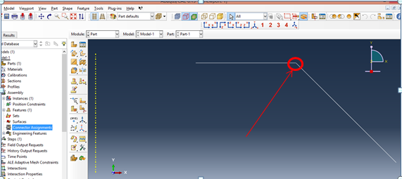

Hi all
First post from a novice to abaqus.
Trying to find help on how to create a joint between the two rods in the picture.
it must be able to move in two axys... Would be very thankfull to anyine able to help.
nice weekend to all
regards
jose - Portugal
RE: Help creating 2 axys connector
Connector type "Join" or two Equations.
Is there a way to apply the joint to several ones at once or do i have to do it one by one?
Connector -> Coincident Point Builder
