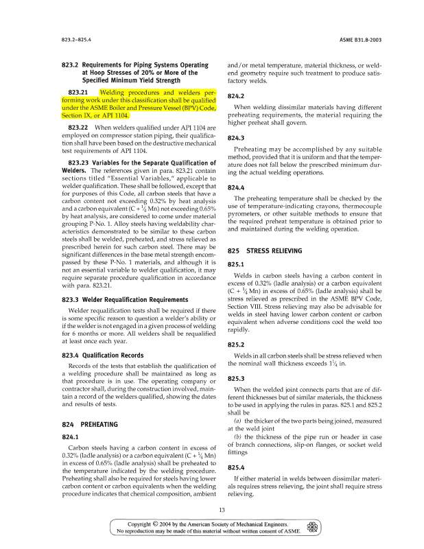

RE: Pipeline PWHT
Please see sec 823.21 AS ME B31.8
It give the tow options AS ME IX and API104
