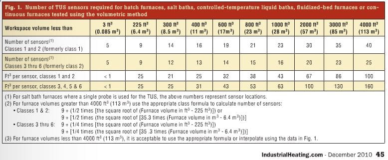

I don't know how closely API tracks AMS 2750, the pyrometry standard for aircraft heat treating.
Industrial Heating ran this table in 2010 for the D version of 2750 (current version is E) for number of thermocouples based on a volumetric calculation.
The table splits the auditor's quantity of 25 and your quantity of 16 at a middling 20 (@57m3)
The original article and table are still on-line at
Link
I'm told that in the aircraft sector the auditor wins these kinds of arguments.
