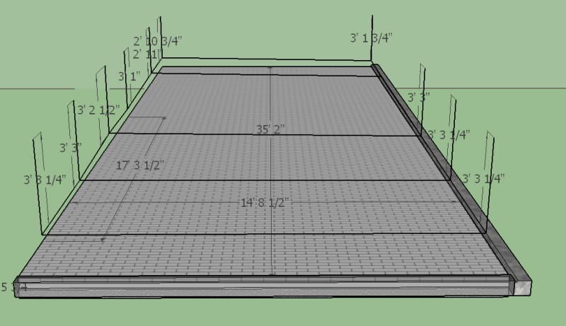

The patio is a warped surface, as far as I can tell, it was sloped as described below.
Taking as reference the horizontal plan of the first floor, (remember this is a raised bungalow) I measured the quotes of a couple of points on the patio. Here are the results:
The patio surface represented in the above picture is the ideal representation with the bricks at grade level, in a perfectly horizontal plan.
The schematic representation is what it was actually measured. The top of the picture is the North side.
The line with the two 3' 3 1/4 quotes is aligned with the wet corner showed in the picture above.
The patio settled in a couple of areas next to the wet corner
After fixing the slope of the patio I have the South East corner as the lowest point (the slopes are now along the red and blue lines represented in the initial picture)

RE: Is it acceptable to have a patio built on limestone screening only ?
I bring up the perimeter drain thing since many of them have been known to fail and cause this dampness.
Drainage and infiltration problems are not always "localized" as you imply. I recall one long apartment
building where the known source of surface water infiltration was 150 feet from where it eventually entered the building.
Your source may be a large area away from the "swale" in part.
In your patio, the slope appears to be so gentle that infiltration into any porous zone below those pavers
at any part of that area is a possibility. So fixing the immediate area of apparent infiltration may not do it.
Crushed rock screenings can be sufficiently porous that you may well need to "fix" the whole patio area. This is where
a little work here and a little there will drive you nuts.
