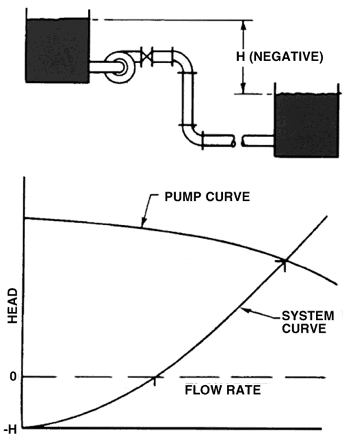

You will get more flow in your system when pumping downhill.
You need to plot a system curve and the point of operation is where the system curve meets the pump performance curve.
If you look at the diagram, the static head offsets the curves by the static head difference.
In the illustration above, some flow rate will occur by gravity head alone. But to obtain higher flows, a pump is required to overcome the pipe friction losses in excess of "H" - the head of the suction above the level of the discharge. In other words, the system curve is plotted exactly as for any other case involving a static head and friction head, except the static head is now negative. The system curve begins at a negative value and shows the limited flow rate obtained by gravity alone. More capacity requires extra work.
You need to develop the actual pump curve to graphically compare the pump head and the static head.

You're looking at this the wrong way around by thinking that the pump is determining the flow rate. Centrifugal pumps will increase flow until the resistance to flow matches the pump outlet head. Look at bimrs system curve.
To get 150 gpm, you need to reduce outlet head compared to 300.

bimrs excellent graph shows you your issues. You have a fixed head from one tank to another and if you open the valve you will get a certain amount of flow assuming that both tanks are held at the same pressure. That flow is the intersection between the horizontal dashed line and the system curve.
To get more flow you need more head at the outlet which is supplied by your pump. So continue your system curve until yu get ot the flow you want. Your pump curve will be provide that EXTRA head on top of the static head you have.
Yes the inlet head/pressure will be influenced by the pressure your tank is at. In your case that pressure is effectively cancelled out by the same pressure in the receiving .tank, but it is better to add this to both sides of your equations in case they are a bit different.
