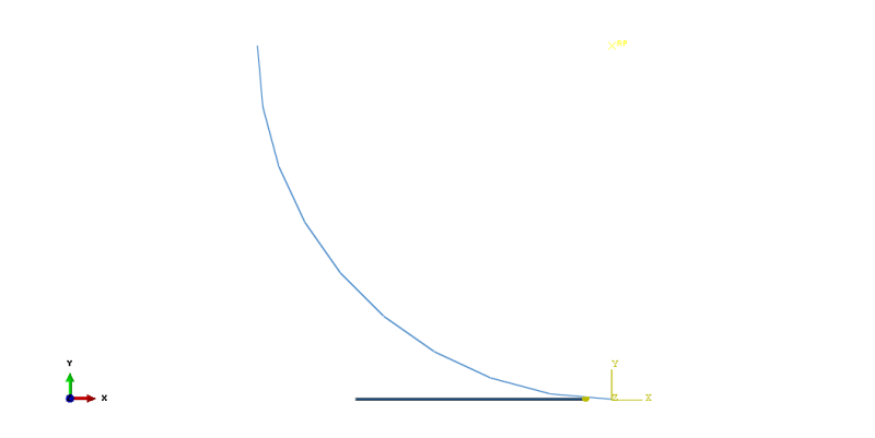

I have developed the rolling process in 2D.
The slab's geometry before the rolling was:
-length: 120 milimeters
-height: 2 milimeter
After the rolling process:
-height: 0.9 milimeter
Relative displacement in 1 direction: 8.82149e-005 milimeters
Why there is no increase in strip's length? It is very weird. I do not understand it. Some of the material disappeared, or what?

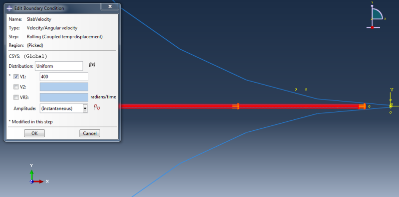

I figured out where the problem is. The problem is with the slab speed application. This is the Temp-disp analysis, so the velocity can't be applicated in the predefined field. It has to be defined as a BC condition. Look at the figure:
That way of velocity application (to whole slab) constrained any other move in X-direction, that is why there was no increase in length.

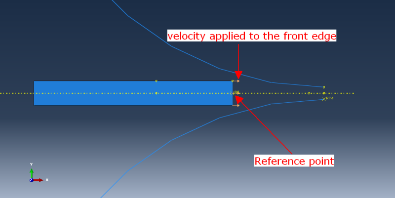

I changed section to Generalized plane strain. I changed element type to Generalized plane strain.
I defined the reference point and I applied the velocity to the front face. See the figure below:
I do not know how can I fix the two out of plane rotations to zero.
Anyway, without that fixing, the simulation crashes after short time and the error is: "Too many attempts made for this increment".

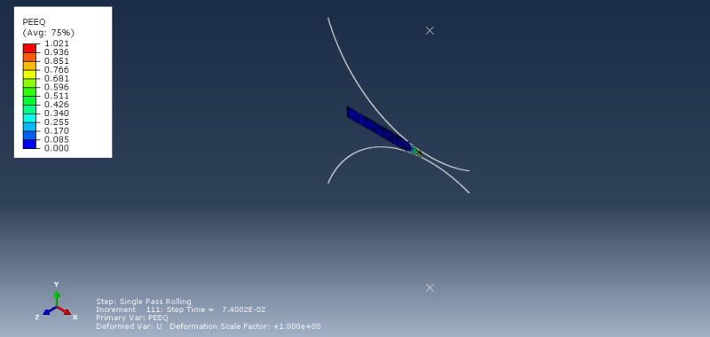

The moment of simulation crash have been shown in figure below:
When I enter to the results module, the first what I see is the rotated image:
Is it due to lack of that fixation, which you were talking about?

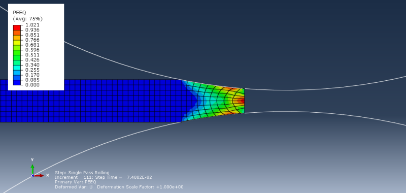

Here's a picture of the model I ran the just used half a slab and the top roll.

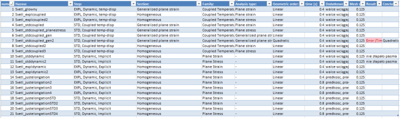

At the moment I run many of simulations with various parameters (different step, element type, speeds, etc.) to do that. There are also no coupled temperature displacement models. Additionaly in some cases I have turned off the material's speed BC and I positioned the material in such way, that it is in contact with the roll at the beginning. The roll should pull it.
Here is the screenshot from my excel sheet with my models description:
These simulations are running at the moment. The problem is that it takes a long time - a few hours in the best case.

After about 15 simulations with various parameters I realized, that only EXPLICIT with plane strain elements was succesful. I obtained the elongation. I think that if I do not apply the expansion coefficient to material, then I do not need the generalized plane strain elements (error appears when I apply them).
So, at the moment I will realize my target model and if some bugs appear, I will ask you for help.
