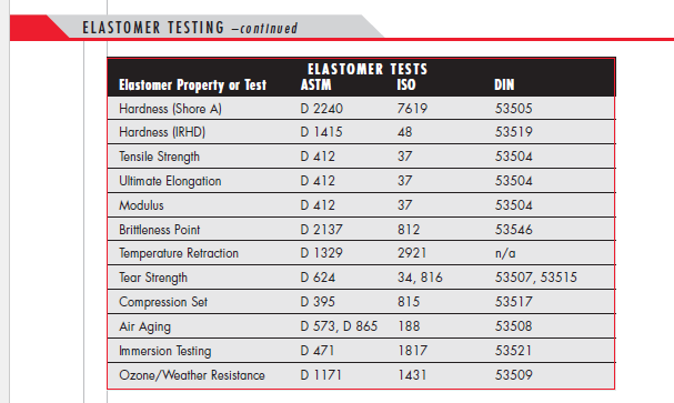

FKM (Fluorelastomer): I would like to know if I can test this material in accordance with ASTM D638.
ASTM D368 is adequate for this kind of material? If not, how can I test tensile properties for this material?
RE: FKM (Fluorelastomer): I would like to know if I can test this material in accordance with ASTM D638.
First off, ASTM D638 is withdrawn with no replacement. Second, it was a specific gravity test so it does not apply to tensile strength. I believe ASTM D395 is the standard test for tensile properties of rubber.
Quote (PCS30)
ASTM D368-89(1995)Standard Test Method for Specific Gravity of Creosote and Oil-Type Preservatives
Maybe this table will help:
