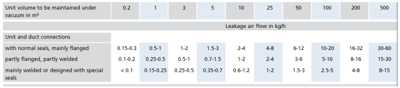

The figures from HEI apply for properly sized and maintained vacuum system. It doesn't really make a lot of sense to use numbers which are an order of magnitude above these figures. Some resources recommend to add 2-5 lb/hr on top of the number as calculated by HEI, to account for various additional connections throughout the system.
A great resource on this subject is "Encyclopedia of Chemical Processing and Design: Volume 61 - Vacuum System" by J.J.McKetta. Some parts are published online (see https://books.google.ro/books?id=RNXyYP8EA2EC&... in particular pages 19-52.
The image below is from GEA Vacuum Systems and they refer to HEI standards as well, with consideration given to relative number of flanged vs. welded connections. See original resource, page 2 at: http://produkte.gea-wiegand.de/GEA/GEACategory/146...
