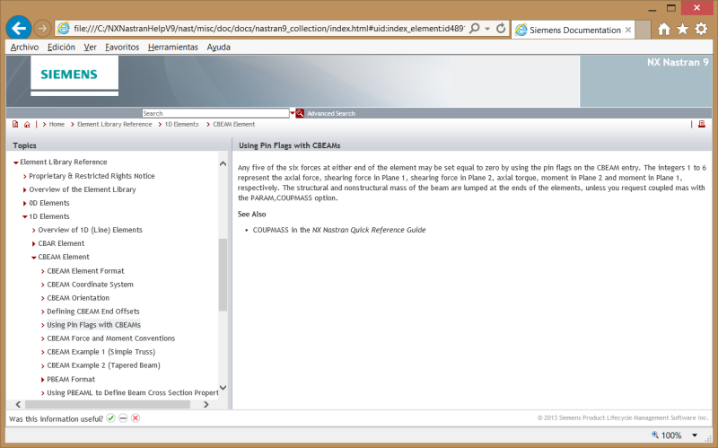

Hi!
I found closed thread named "Attaching Plate Elements to Beam Elements" in which rb1957 wrote something aboute release of a freedom. I'm very interested how to change relationship between plate and beam elements (release chosen DOF). My construction is 3d frame, and roof (plate elements) can't be part of load-bearing structure. Look at the picture below.
I want to release all rotational degrees and some translation degrees along chosen curves.
I don't know how to do it. I really appreciate any tips and tricks.
Regards!

Hello!,
You can release DOF at ends of beam elements, this is named the PIN FLAG feature, take a look to the CBAR/CBEAM elemenst in the NX NASTRAN manuals to understand how it runs.
Also, you have an example explained in my web site in the following address (in Spanish, of course -- use GOOGLE Translator):
http://www.iberisa.com/soporte/femap/cbar.htm

RE: release DOF in cooperation between plate and beam elements
To do it with Femap for Bar / Beam elements go to Modify/Update Elements/ Beam/Bar Releases
