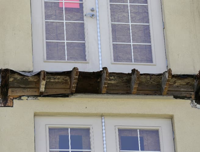

looked like the joists were rotten

Another engineer said water penetration caused dry rot in the framing. I thought dry rot was fungal and not water caused?

How can you tell the joists were rotted in a photos taken from 200' away? Has there been any reports saying that the joists were rotted?
RE: Balcony Collapse in Berkley, CA
yes, fox news this morning indicated that rotten joists (with a close up photo) might have been to blame

joist breaks appears irregular and discolored (dark, not fresh wood)

looked like the decked was deteriorated to mush
The picture posted shows white deposits on the joists- probably calcium carbonate from water intrusion. There is OSB sheathing on top and what appears to be the remnants of a stucco covered gypsum board soffit.
The moisture barrier on top of the deck could have failed quite a while ago, allowing water intrusion over an extended period of time. This deck probably gets a lot of sun and rain as well, which sets up a wetting and drying cycle. There has probably not been much if any waterproofing maintenance which allowed the wood deterioration to advance to the point that the joists had only a fraction of their original capacity.
The building owner should inspect all other decks, particularly on this face of the building and initiate immediate structural and waterproofing repairs.

Wondering if the water ponded on the balcony, poor drainage detail, non-ripped to slope joists ... not a lot of rain in California.
Reading through the posts above - several very good posts, BTW - I see that no one chose to highlight what was likely the cause: lack of proper drainage of the balcony surface. Several of you cited lack of treatment of the joists (pressure treated), and some of you questioned proper use of the building code design live load. However, if the balcony had drainage properly installed and well maintained, then the serviceable life of the joists supporting the balcony would have been greatly enhanced.
The photo posted above does suggest lack of a proper drainage system. Rainwater was likely allowed to pond on the surface of the balcony, spreading over its surface. I think this is why we see fairly uniform deterioration of all of the joists; if there was localized deterioration, then I would have blamed a leaking drainage system.
To compound the situation, I question whether there was a proper moisture barrier in place that would have prevented - or at least limited - the amount of water infiltration into the joists.

If you look closely at the balcony below there is what seems to be a small drainage hole with drain marks in the centre and the deck has a small upstand all the way round the edge. The destruction of the beams seems extensive and spread over all the beams. Maybe water entered the void under the decking and just created a moist humid atmosphere allowing fungus and rot to develop.
It could be something as simple as someone nailing on a top surface to the decking and puncturing the rather flimsy plastic sheeting that is evident.

Your friend's photos show 3 views of one corner of the collapsed balcony, and I think it is an exterior corner. So I don't see how these photos support your assessment. If the joists were indeed pinned at the wall, how do you explain the photo which CTW posted above?

You, are correct.The engineer sent me photos of the end of the balcony and said it was the connected end. P.276 Breyer "design of wood structures": "cantilever beam systems are not recommended for floors".
Do you think anyone would attempt to design a wood cantilever balcony connecting into a face mounted plate?

If the berkleyside photos are of the balcony pre-collapse then I'd say the design is fundamentally flawed. There is no good that comes from putting a concrete floor over wood and then walling it in from the bottom to prevent inspection of the condition of the structure. I wondered how the people could not feel the sponginess of rotting wood, but it looks like the design was practically created to kill people by preventing any discovery of wood rot, and it was designed to hasten the process.
Why doesn't the membrane extend up and into the dwelling instead of being used to funnel water into the wood? There's no other drain path provided.

Based on the details of the original design as shown, there is no means of secondary drainage from the balcony. In a proper design, there should be drainage at the membrane level as well as runoff from the surface of the concrete.
Further, it appears that there was a water intrusion line about a foot off the joist attachment. This indicates a linear breach of the membrane. Was the first joint or the counterflashing joint not adequately sealed? Only a proper investigation will determine.
Even though we're not there and can only speculate, it is clear that the balcony waterproofing design and construction were contributing factors.
It looked to me like the detail put the flashing under the membrane and called for caulk to prevent water from funneling from the top of the flashing under the membrane. I think that one should never put an uphill-facing joint where water will drain. Membrane should have extended up the wall and under the door frame extrusion. If there is some requirement for metal flashing, that should go over the membrane so the gap faces downhill.
The rot seems to be maximum where the detail indicates the flashing would end. The lower balcony had some leakage but did not look rotted. Maybe the lower balcony had the flashing over the membrane; the membrane extended up the wall; the caulking was better for some reason; the upper balcony deflected the majority of water from that part of the lower balcony.

What we generally find in investigations is that very few people (architects included) understand how water travels in building. They don't even seem to understand the two main principles of water usually-but-not-exclusively flowing downhill and humidity permeating any contained space. Repeatedly, balconies fail and walls rot because "that cut/tear/hole is not big enough to let _much_ water in..." The history of EIFS as one glaring example.
Someone mentioned the white deposits on the wood remnants. That is most likely salts coming out of the wood AND fungus byproducts, it is very commonly seen on wood that has been routinely or repeatedly wet.

Nevertheless, from the photo posted above, it seems rather obvious that the cantilevered joists were pretty deteriorated from rot caused by water infiltrating into the building envelope and that rot was a significant contributing factor to the collapse of the balcony.

(Despite the somewhat unclear plans photo, I will weight in on what seems to be a problem so designers will avoid it.)
That drawing seems to show a saw cut top chord of the cantilever lumber. This would probably change the grading of the lumber and if pressure treated, would remove the treated wood and open it up to moisture intrusion. It also opens up endgrain right at the area where the flashing most likely leaks at the face of wall.
The slab doesn't protect the membrane, which stops a large distance before the wall. In fact, it stops just about where the wood rotted. The slab does serve to funnel water that runs down the wall directly to the open edge of the membrane. Had the membrane been continued and terminated under the door sill above the concrete, there would be no opportunity for water to get under the membrane and from there to the wood.

How could it fail in any other way? Look at the simplified example of two joists with a rigid plate on top. Assume the joists are of equal strength and there is some asymmetric weight that overloads one of them. Either the rigid plate tilts dropping all the people on it or the weight formerly shared is now more concentrated to the remaining one, causing it to fail and dropping all the people on it. There is no condition in which the rigid plate experiences a small, telling motion that gives people on the balcony a warning in time to vacate.
For the redundant cantilevers, the end result might have been the same. While there is redundancy, that would only be for as long as the remaining member stay sound. If they were all rotted, then you would get a cascade failure that might happen so quickly that it would be indistinguishable from a sudden catastrophic fail. Moreover, it's likely that the failure was exacerbated by the 13 people on it at the same time. Had there only been, say, 4 people, the balcony might have started to give way slowly, allowing the people to recognize the danger and leave before it collapsed altogether. Certainly, prior to the actual failure, the balcony gave the appearance of being able to support its own weight, which is not inconsiderable, even though the members were already rotted.
While there was some speculation that this balcony shielded the one below, which exhibited, as near as I can tell from photos, almost no rotting, rain water would still have gotten onto the lower balconies. This possibly suggests that the actual construction on that one particular balcony was deficient, which aggravated the less than ideal design. I had that sort of thing happen in my new house; we got some water intrusion, and it turned out that the tar paper had gotten damaged and torn in ONE spot, and water managed to get down to the hole and entered into the wall.
My point in asking about the type of construction is that the posted article seems to indicate that a more redundant system (where all of the joists are cantilevered) would be safer. However, from what I can see, all of the joists do appear to be cantilevered. In my opinion, this type of sloppy writing misleads its readers and is not useful in our pursuit of learning from past mistakes.
BS2: "All the joists appear to be cantilevered." I would like to know what leads you to that conclusion.
Found the pic I was referring to. This pic is what led me to think that this is an outrigger system. If anyone has more information on the type of framing system employed (a pic of the structural drawings showing the framing system would be ideal), please feel free to post it on this thread.
rlflowers,
I agree with BS2 that the joists appear to be cantilevered. What leads me to that conclusion is the photo of the failed joists. They all failed at the exact same location along the span as the two edge cantilevered members that are larger in cross section (i.e. the two you refer to as outriggers). In the system you refer to as an outrigger system, I assume that you are implying that only the two edge members are cantilevered, and that the infill joists are simply supported spans between a ledger at the exterior face of the building and an edge beam spanning between and perpendicular to the two cantilevered outriggers at their free ends. If what I have described is an accurate description of what you refer to as an outrigger system, then I don't think that the infill joists would fail in the manner that we see in the photo. Don't you think they would fail at the simple support at the ledger at the face of the building?, especially if it was a toe nailed connection, which it would have had to be since we don't see any joist hangers at the face of the building. I don't think this is the system that we see in the photo. They clearly look like cantilevered joists to me.
I agree with gte, they are all more likely than not cantilevered. I often put in a bigger edge beam because it makes other things easier, like connecting guardrails and such.

Some photos show the inside joists extending past the set of horizontal slats(?).
I fail to see how everyone on this thread concludes that these joists are cantilevered. These photos can only give us certainty that these joist bear upon the wall; there has been no means presented on this thread that can suggest that these joists extend beyond the wall - a backspan - to another line of support. Indeed, we are only looking at photos taken from the outside of the wall.
Yes, the stubs remaining of these joists have not significantly rotated as a result of the failure, and that does suggests some measure of restraint to keep them somewhat horizontal; however, there was not much strength left in these members to cause such a rotation at the moment of failure.
We have a lack of information, gentlemen, and we are jumping to conclusions. Again, all I have to go on - as shown on the pic I have posted above - is that the outlying "joists" are thicker than the other joists. This leads me to the likelihood (not certainty of course) that these are outriggers. Why else would these members be thicker than the others?
So, yes, of course I may be incorrect in stating that this is an outrigger system. But the point of my article was NOT to insist on this, rather, to suggest an opportunity to explore two types of balcony construction.

With respect, I think you are the one who has jumped to conclusions, and placed your conclusions in an article for public consumption. Did you see the framing plan? It seems to show cantilevered joists, but that is just my conclusion. A cantilevered balcony is a cantilevered balcony, no matter how many members cantilever.
No I haven't seen the framing plan, hokie66. So, please, if you can, post a pic of the framing plan.
In this thread, ChiefInspectorJeff posted the framing plan 23/6/15, 2311. Not very clear, but I think it shows all the joists cantilevered.
Thank you hokie66. I see that it was posted three days before the article was posted; however, I wrote that article on the 23rd. Had I realized that the floor framing plan was posted, I would have reviewed it before writing the article.
So, yes, that is a true cantilever system rather than an outrigger system. I was fooled by the larger members in the pictures. The joists were "ripped" to allow the shallower depth required for the concrete deck on the balcony.
Anyways, although I have stated in the article that this is an outrigger system, the intent of the article does not hinge upon what this particular system actually is.
There are 2 balcony framing types. One is joist supported on each end by hangers.
The 2nd is the type that collapsed which consist of cantilevered from an inset inside the floor edge lam beams and between them non p.t. joist.The blocking at the interface of the building makes it hard to see the inset joist.
My theory is that the stucco leaked into the wall from an area about 16' high and with no deck above to block the rain dripped into the wall behind the flashing and floor membrane.Also flashing nails are highly suspect.
I see no weep screed at the base of floor 5 to drain water.
Also the membrane looked short and not going up behind the metal flashing on the detail at the door.It also looks like the decay occurred at the membrane lap.
I'll have info from the man at the scene.

Maine Professional and Structural Engineer. www.fepc.us
Quote (IDS)
9) Any structure where collapse could lead to human deaths must be designed with sufficient redundancy so that it does not collapse when any element fails.
My earlier comment applies to items 1) through 8) for reasons I do not particularly wish to discuss at this time, but it applies also to item 9).
I am trying in vain to think of an example of a structure where collapse could NOT lead to human death.
Are you sure you want to make a code provision requiring sufficient redundancy so that a structure does not collapse when any element fails? Where is the redundancy in a simple beam carrying floor or roof members if the simple beam fails or if one of its end connections fails?
BA
Quote (BAretired)
So, clearly all structures must now have a height restriction of 4 feet or be designed with 100% redundancy.
"9) Any structure where collapse could lead to human deaths must be designed with sufficient redundancy so that it does not collapse when any element fails."
I think that already existed. If any single cantilever had failed, the balcony could probably have survived that. ALL the cantilevers failed, and it was overloaded.
TTFN
[IMG http://tinyurl.com/7ofakss]
Of course I can. I can do anything. I can do absolutely anything. I'm an expert!
There is a homework forum hosted by engineering.com: http://www.engineering.com/AskForum/aff/32.aspx
It collapsed because there was no effective redundancy.
As has been discussed already, there are several mechanisms by which cantilevers might be constructed so that they don't collapse if the primary support fails, but this balcony did not have any of them, in common with many other balconies in the world.
Doug Jenkins
Interactive Design Services
http://newtonexcelbach.wordpress.com/
The lack of redundancy did not cause the collapse, rotten wood did.
What would happen if the redundant supports also rotted? Just because something is non-redundant doesn't make it unsafe. What was really needed was more ductility in the structure, then failure could be identified before collapse.
You can't prevent all deterioration of materials. Structures should not collapse when their materials deteriorate, especially when collapse results in people falling to their death.
By redundant I mean that it should have sufficient strength in some other load path that it doesn't collapse. There are many different ways of doing that, including using materials that will have large deflections before they lose strength.
Doug Jenkins
Large deflections before they lose strength? You mean like the gusset plates on the lateral braces of the I-35W bridge in Minneapolis?
Thaidavid
Either the recent leap second or 4th July has resulted in some posts being inserted out of sequence, or maybe I just missed them.
The statement: "Any structure where collapse could lead to human deaths must be designed with sufficient redundancy so that it does not collapse when any element fails." is supposed to be a statement of a general principle, not a design standard clause.
Certainly it's easy to interpret in such a way that it doesn't make sense, but it is also possible to interpret it in context, in a way that does make sense. The question is, if we do that, does it imply that the design of some structures should be handled differently? I think it does. The questions below relate to all accessible external balconies anywhere in domestic or public buildings:
- What is the maximum load that can be expected over the life of the structure? - As many adults as can squeeze onto it.
- What is the probability of significant deterioration of the supporting materials over the life of the structure? - In many cases high.
- What is the probability that this deterioration will go undetected or untreated? - In many cases high.
- In the event of one supporting member failing what would be the result? - In many cases sudden total collapse, likely to result in multiple deaths.
- Are there any practicable measures that could be taken to significantly reduce the probability of such an event? - Yes, there are several.
So other than a very small increase in the overall construction cost, what is the drawback to a requirement that balconies should be designed to be safer in the event of overloading and/or deterioration?
I don't think that redundancy assists, except perhaps to give a false sense of security. I don't see anything about redundancy in the city's report. The part about mandatory inspections will be soon forgotten, as no engineer in his right mind will be willing to certify these things without proper access. The durable materials part is key, although that too can be abused.
hokie66 - how can you say that if a structure is designed so that it does not totally collapse as soon as one member fails, this does not assist?
The fact that in this particular case a report does not mention lack of redundancy as a factor just shows that the standard approach to design for collapse needs to be changed.
Doug Jenkins
I just think redundancy is overrated, sometimes at the expense of making sure that no members or connections fail. I can't think of a way of making a cantilevered wooden balcony more redundant this one was, unless you are going to use hangers or columns.
Connecting the parapet rail to the wall is the third way that has been mentioned.
I don't see anything wrong with any of those options.
Doug Jenkins
Quote (IDS)
I don't know how you could expect that to practically and predictably work.
"It is imperative Cunth doesn't get his hands on those codes."
I don't see why it would not work. The balcony rail will be fabricated from steel tube stock and be anchored to the host structure and to the wood deck end members with lag bolts or threaded rods. The railing would be a cantilevered braced frame attached to the host stud pack which is attached to the joist or studs below with a HD 7A hold down or similar.The floor would be a fully blocked diaphragm with glued and screwed 2- 3/4 Plywood skin similar to an airplane wing.If the joist rotted the remaining blocking could form a T beam with the subfloor.
Another easier option is use steel floor joist or angle irons.
Or a 2 way slab on junior I beams.
If you look at the photo of the railing it is very heavy duty.
Inspector Jeff
Something still doesn't feel right about that scheme - the blocking acting as flexural members...ehhh? Are you proposing your scheme be part of the code? There is a saying that you shouldn't count on structure that doesn't look like structure. Pedestrian guards look like they perform one function, and that one function is not as a secondary structural system for the balcony. At some point in the lifetime of every building renovation, railings are replaced.
Just a datum: I believe the collapsed balcony and the one directly below it were the ONLY two on the entire building. Probably owing to the "softening" of the "look" mentioned somewhere above and probably implemented at the last minute in the design. (Probably the first step in the Disaster Chain)
The building seems to have an extensive exterior stairway leading down the face of one end of the building. Hmmm, I wonder if it should be checked as it looks to probably have the same sort of drainage needs as the ill fated balcony.
Google Satellite
Keith Cress
I really don't see why not, but the point is that even if it only just works it has done its job.
If balcony rails are maintained, that's good. If the connection to the wall is removed (or replaced with one with insufficient strength) during maintenance that's bad, but the resulting system is no worse than the current standard design.
I will make some more general comments in the new thread.
Railings are typically not structural elements in this type of balcony. In order to completely handle the 1440-lb load that the balcony was supposed to handle will require:
> way more fasteners
> way stronger wall
> way stronger flooring on the balcony
> way stronger railing.
TTFN
IRstuff - The point is that it should have sufficient strength to prevent total collapse in the event of the main support failing.
I doubt that the changes you listed would be required in the case of the balcony in question, but if they were one of the other options could be adopted.
Are you really suggesting that these structures have no practicable way of providing a secondary support mechanism that would prevent total collapse, or at least substantially reduce the risk?
Doug Jenkins
I mean, don't get me wrong, IDS, I employ "belt and suspenders" frequently without anyone noticing. But, to me, you don't provide suspenders when it can double the cost of the structural system(balcony in this case). Further, without a sketch of these ideas, I still have concern about the load-path of the scheme. If you are explicitly designing a redundant frame, you own all of it. Which means the reliability of the redundant system needs to be greater than or equal to the sub-system you think could fail (good grief that sentence sounds ridiculous).
I think Occam's Razor is being violated...
"Are you really suggesting that these structures have no practicable way of providing a secondary support mechanism that would prevent total collapse, or at least substantially reduce the risk?"
In some cases, yes. It's not that different that when we demand a certain failure rate, that we essentially have to duplicate the entire suite of hardware. The balcony in question has redundancy; what failed was not the redundancy, but the water intrusion protection; that was the weak link, not the joists. To demand an additional full redundancy would make the balcony way more expensive than it's worth in rent, and we would essentially restrict ourselves to buildings with no balconies, which would be a poor state of affairs.
Note that the lower balcony had ZERO water damage, which is what the design result should have been for the upper balcony. There have been several suggestions as to how that might have been accomplished, without resorting to redundant structures. There are balconies that have existed for centuries without failure, and without redundancy. To immediately demand redundancy seems to me to be a bit of a knee-jerk reaction.
TTFN
The point is that all structural systems have potential for significant degradation over time. Providing a secondary system to prevent total collapse in that eventuality does not need to cost as much as the original system, or anything like it.
As for the balcony having redundancy, I don't see any.
To suggest that redundancy is a totally impracticable requirement seems a bit of a knee-jerk reaction to me.
Provided that the redundant system does not reduce the reliability of the sub-system, then the overall reliability will be equal or better than the original system.
Jeff, possible maybe - but super messy to me. Also, there is going to be a lot of moment introduced into the wall, which will make things worst for detailing. Not sure how the HD7A is doing much of anything - a column will need to resist the moment and then transfer shear to the floor, not tension.
Just one correction, as I won't argue any more about redundancy. The lower balcony did have water damage, according to the city's report.
Quote (IDS)
Yes. Though, what I was getting at is that (if you are going to open the can of worms) you have no choice but to assume the base system fails in its entirety (as the subject structure did), or else when something happens you have to explain why your belt and suspenders only has the belt and one suspender.
My reference to Occam's Razor is me suggesting that the redundant cantilever scheme may not be an elegant solution to the problem.
MacGruber,
Yes, it is messy but uses a few bolts and hold downs and some blocking.
Would not the M be resisted by the HD7A tying into the dead load of the tributary floor and roof? The bolts into the wall might need bearing plates to spread the load.
Wouldn't the braced frame railing resolve into a couple of C=T at the interface of the stud wall, similar to a shear wall?I'd push for galvanized joist with weep holes in the bottom flanges and vent/ inspection holes.Any way you do it wood is messy and difficult to connect properly.
Inspector Jeff
Jeff, I don't think so. Based on your sketch, you introduce a couple directly into the wall. The wall will resist the couple via a moment internal to wall studs, a post, etc. The line of action of your tie is right in the middle of the wall, so the moment can only resolve itself into a horizontal shear force at the sole plate (i.e. the base of the wall is pinned).
Also, along with hokie (I think), I am kind of tired of discussing the redundancy solution. I will end with this - I challenge the redundancy advocates to try it out in real life and report back.
"As for the balcony having redundancy, I don't see any."
Let's suppose that the balcony was only supported by the outriggers, and further suppose that a sensible design would have made each of the outriggers capable of supporting the entire load of the balcony. Then, by definition, there is redundancy. Since the balcony actually has 5 joists in addition to the outriggers, I think that meets the literal definition of redundancy. The fact that they all failed at the same, or nearly the same, time does not void the redundancy. Even if the railings had been a tertiary support, the same rot that affected the joists could have just as easily been located on whatever the railing might have been anchored upon, since each fastener requires penetration of the outer wall, and runs the risk of water intrusion.
My point is that there are always failure points; they're unavoidable. Even the redundancy professionals get it wrong sometimes, such as in the case of the DC-10 hydraulic systems, which were fully redundant, except at one specific spot in the tail, which was tolerably protected, until the rear mounted turbine developed a catastrophic blade failure, and took out all the hydraulics which had no cable backup, since it was nearly impossible, statistically, for all redundant hydraulics to simultaneously fail.
The issue is that redundancy is a slippery slope; where do you draw the statistical line in the sand, and can you live with the consequences when the line is crossed. Much of redundancy reliability is tied to the statistical analysis of probability of occurrence. So, even in the best case, an unknown probability can be assigned a lower value than what is real. Or, equally likely, the probability is correctly remote, but that probability card just shows up in the deck.
Case in point, and even considering the other balcony failure just reported, what is the statistical likelihood of a balcony failure? Is it one failure per million balcony-hours, or one per billion, or even trillion? Would any seriously contemplate potentially doubling the cost of a balcony to prevent a one in a billion balcony-hour failure probability? What about all the other one in a billion balcony-hour failures? Do we protect against them as well? The balcony-hours as I use it here is the number of actual balconies multiplied by the number of hours, so assume the the US as 70M housing units and 1/100 have a balcony, and assume there is one balcony failure every 2 years would result in 1 per 12 billion balcony-hours as the failure rate.
TTFN
I too am a big fan of redundancy -- especially in places where you can do so easily.
Take a car. It makes a lot of sense to me to have a traction-control system. Divert power from wheels that are slipping to those that aren't. Good redundancy.
But you can't do it everywhere. You wouldn't mandate a fifth wheel just to provide redundancy in case the four wheels stop working. That doesn't make sense. Those first four wheels just need to be engineered to work.
Same with this balcony. Providing a second load path is good when you can do it smartly. But this cantilevered system just needs to be engineered to work.
I agree with much that's said here. A few thoughts:
  1. Making cantilevered joists PT. Why not? Makes sense.
  2. Watertesting some percentage of the balcony water proofing before covering it with finishes. Preferably with a third party. Won't help deferred maintenance items but it should at least keep people on their toes during construction. I don't see why this doesn't make it into Masterspec, if not the codes.
  3. Drilling holes in the sheathing under the waterproofing. This could at least let water drain should it get trapped under a lapped flashing joint. The leak would at least be visible underneath.
"We shape our buildings, thereafter they shape us." -WSC
PT does not last forever. Just means the collapse will be some years down the road. Yes PT but that is only a small part of what can never be an entirely satisfactory solution. Annual inspection is another part. It is pretty hard to build redundancy into a cantilever. I like Hokie66's response, namely do not build cantilevered balconies in wood. Don't forget that PT when the lumber is incised as it generally must be, has a big strength reduction factor, but at least that can be accounted for in the design. When the wood eventually does rot, there seems no alternative at that point than to cut the balconies off.
So, we are all agreed then
On the basic principle, if not the application to a particular class of structures.
I do note however that there is a good deal of what I call either-orism in this thread.
Those who think additional redundancy in balconies is a good idea think the cost would be trivial, and those who think it would be a waste of time think it would be horribly expensive.
Funny that.
Doug Jenkins
Quote (undefined)
For a structure to be redundant to prevent this type of collapse, it has to last longer than the primary structure, not be affected by whatever might cause the primary to fail, and possibly take a higher load due to energy added to the structure during the failure of the primary support (as in dropping and being suddenly stopped by the back-up.)
If the designer knows all about this, why not use this to design the primary structure so it doesn't fail?
The belt-and-suspenders concept is appealing until the realization that neither belt or suspenders are under much load and that well fitted pants will stay up without either.
Regardless of cost, designing and building a structural back-up is very difficult, particularly to offset a basic deterioration unrelated to structural use. Even designing a structure to fail gracefully under overload when the parts are in like-new condition is hard.
Given sufficient time and money, we could all generate a balcony that would not have failed in the same way as this one. But they each may fail in a different way due to the same or different causes. What we do all the time is to make our designs "good enough" because that is the economics of our profession. In this case, we all probably agree that given the outcome, the design and/or construction was not good enough.
It is easy enough to look a failure and determine the cause. How we react as an industry is what matters. There were a series of things leading to the final catastrophe. A fault tree would be useful, but I don't feel like drawing right now, so below is a ludicrously over-simplified assessment of how things got to where they are now:
failure: balcony fails due to deterioration of multiple structural members arising from undetected (or uncontrolled) water intrusion over a period of time.
Anywhere along the road to failure, this could possibly have been avoided. Some controls work better than others:
If the water intrusion had been properly prevented
If the effects of water intrusion had been mitigated
If the materials used were not subject to water damage (treated lumber or other material selection)
If the engineer had recognized that water intrusion was likely and specified appropriate materials
If the water intrusion had been detected and fixed
If the builder and his personnel had known about this issue and been more careful
If the owner or architect had required special inspection of the waterproofing
If the engineer had added separate redundant load path not subject to water damage from the same leak(s)
(aka If the structure was redundant enough, in the right ways)
If the building had not been built because they could not afford to construct a building costing more than one designed to minimum requirements.
Some new info on this here if you go down to the bottom. http://www.eng-tips.com/viewthread.cfm?qid=389494
Will be interesting to see how many balconies start disappearing in Berkeley because no one will sign them off as being "free from..."
