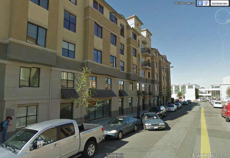

From google earth
I these are the building

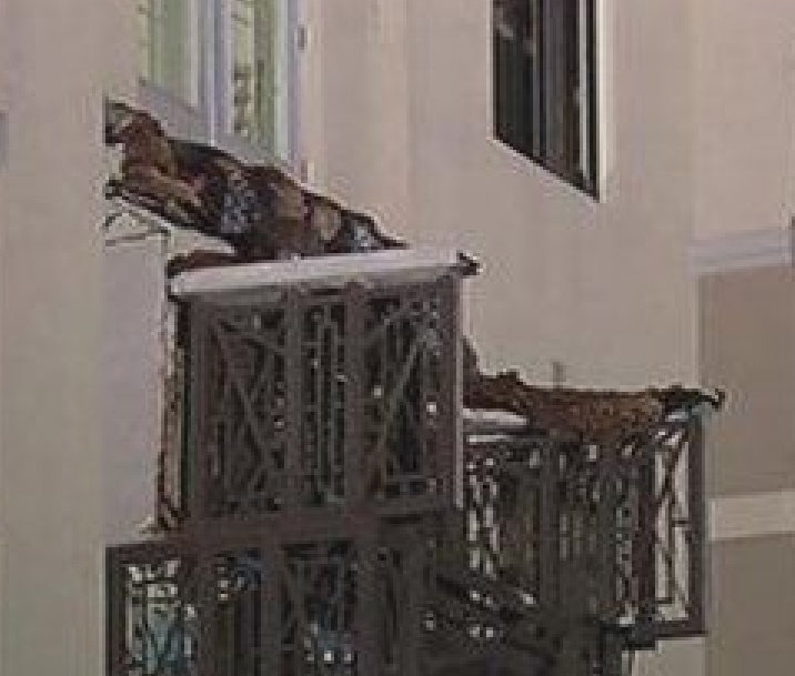

A pic on the BBC shows what looks like wood joists cantilevering out broken right at the face of the wall. Looks like it rotated about the wall and landed upside down on the balcony below.

It looks like the balcony ended up upside down on the lower balcony with the side that was facing the door now facing out. And part of the floor still attached to the original floor, this makes the balcony look like it has no floor anymore.
So the balcony rails let go of the building and the floor started to deflect as a cantilevered beam is prone to do. This would throw the students away from the building making the loading even worse. The balcony bent so far that it managed to flip coming to rest on the balcony below it and dumped the students over the edge some to the lower balcony and others four stories to the street below.
RE: Balcony Collapse in San Francisco
this is a much better image. Note that there is no wall damage to the sides of the double doors, so the balcony was solely supported by the cantilevered beans. The wood looks wet or rotted.

Sure does look rotted. Also looks like TJI's which are not usually treated. I don't think you can treat them. Need an envelope engineer on this one.

Cantilevering light wood members from inside to outside is a recipe for disaster, and that is what happened.
doesn't look like the cantilever was more than 4', unless my perspective is off
from a local SE reviewing photos on behest of media..."While stressing that his assessment was preliminary, St. Onge said, “This appears to be a classic case of there being inadequate waterproofing at the point where the deck meets the house. If the waterproofing is substandard, rainwater can enter the building, causing dry rot, which can destroy the wood members within a short time, i.e. only a few years from construction.” "
