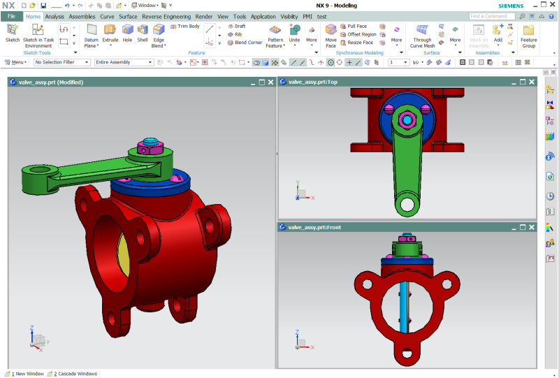

In the view menu Layout>new command, NX simply support only 6 type arrangement.
Arrangement L1 is single view and others are 2,4,6,9 view only..
But I want to create 3 view layout, it's left is iso, and right upper is top view, right lower is front view,,
It's possible? How can I create this?
RE: Create a new view layout,,,
There are no ad-hoc 'layouts' in NX, you have to follow one of the formats under the Layout function.
That being said, there is an alternative and that is to use three individual NX 'windows', sized and positions as you've described and as I've shown below. You can set-up these by going to the 'Window' item on the very top of the NX window and first select the 'New Window...' item as many times as you need additional NX windows, in this case two times. Now go back to the 'Window' item and select the 'Cascade' option. Now you can size the windows and arrange them how you please.
