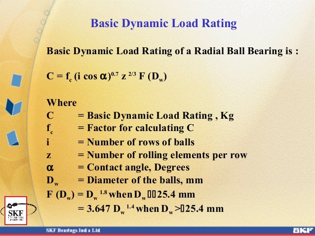

There is an equation to determine the dynamic load rating "C" of a bearing. It takes into consideration only the geometry of the rolling elements in a bearing. Things like the number of balls or rollers, the diameter of the balls or rollers, the length of the rollers, the contact angle, etc. are used. By this standard, if two manufacturers make a deep groove ball bearing with the exact same number of balls and the same diameter of balls, they should have the exact same dynamic load rating.
Here is something I found online that shows the equation to be used:
http://image.slidesharecdn.com/1-141227035201-conv...
This is where it gets complicated.
Based on Hertzian contact theory, the C value, based on the geometry and equation described above, is the load at which the classic L10 life will reach 1 million revolutions with 90% reliability (which is to say if we apply to a bearing an equivalent load equal to the C value, then out of 100 bearings tested at this load, 90% of them will surpass 1 million revolutions before the first sign of fatigue (spalling) is visible on the surface of the raceways. 10% of them will not.).
