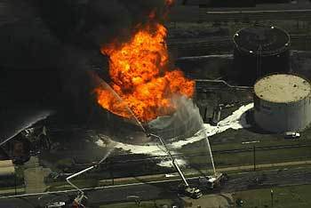

Whatever petroleum container catches fire, basically you just let it burn itself out while trying to keep anything around it cool.
RE: Firefighting for 5km Pipeline
So what's the point of water and foam lines on storage tanks?
They tried that at buncefield, but after a couple of days had to go in an actually put the fires out. They had to wait to gather most of europes available foam supply to arrive before they started, but the fire was so big they couldn't let it burn out. One tank yes, One whole tank farm no.
http://news.bbc.co.uk/1/hi/uk/4525504.stm
Water keeps the adjacent tanks cool. Kills the spills and keeps the grass on the dikes from burning across to the next tank.
Never seen a foam system put out a large tank fire. If they survive the rupture and heat, mostly just make more of a mess really.

Fair enough - they really struggled at Buncefield to put it out and needed an enormous number of fire fighters and fire pumps.

Yes, Buncefield is a good example.
Growing up in Houston was a good introduction to what they don't and can't do with tank fires. We'd go watch them try. Greatest effort went into keeping the surrounding tanks ... and other things cool.
