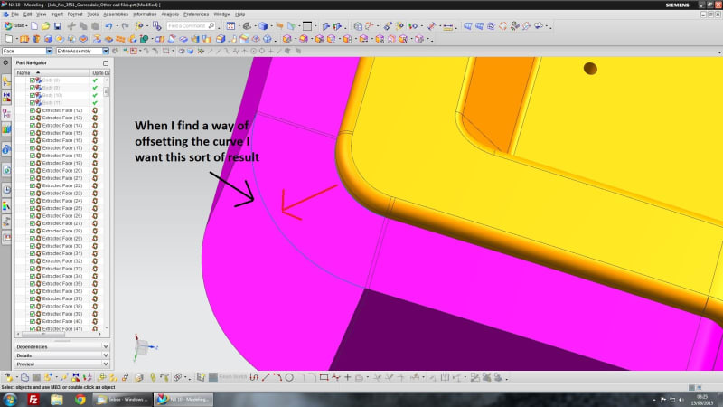

I am trying to offset a curve down a x and y axis so far the only tools I am using will only let me offset in one direction If anyone can help this would be appreciated.
Thank you Daniel Lamb please see picture attached.

Are you talking about 'offsetting' or 'transforming'?

Please provide some sort of picture of what you think you're going to get if you were able to 'offset' the way you wish to? Generally speaking, an offset only goes it one direct, normal to the curve being offset. The is not idea of multiple directions.

Try using offset curve / draft
Maybe it's what you are looking for

I would like this result
RE: offset curve
Can you split out that corner such that you don't reveal anything of that model and upload ?
Offset should do what you expect.

Could you extract the surfaces, then do on offset surfaces? You may need to extend these surfaces together for what you are wanting.
RE: offset curve
What is the end goal? are these runoff or addendum surfaces for a stamping tool or mold shutoff?
if so, i'd just use a bridge curve and use fill surface.

I agree.....bridge curve and fill surface gets what you want, quickest.

Fill Surface is NX9 and improved in NX10. Absolutely wonderful function( NX10) smile
