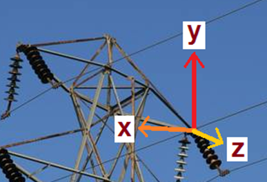

hi gentlemen,
How can I work a model for the type of insulator v-string (2-part) ??
by method1
plz, see attachment
by method1
plz, see attachment

I think there is a Z dimension (x,y,z) for attachment point ??
RE: plscadd
The Type 1 structures only serve to hold the wire up to do vertical clearances for the sag and you cannot judge the strength of the tower. You might be able to generate a report for the structure to determine the loads at the wire attachments to give to a designer.

RE: plscadd
yes,I cannot judge the strength of the tower by method1...its for cost estimate
thank u very much
RE: plscadd
This type of insulator still is being used this date.We call it inverse V ssuspension string. It is used when vertical departure angle is exceed certain number which could damage the cable. Yes, sometime it can be fix by big departure angle trunk on clamp, however some utility still use. For PLSCADD model, u just simply model it as a regular suspension string as gentlemen above mentioned.
