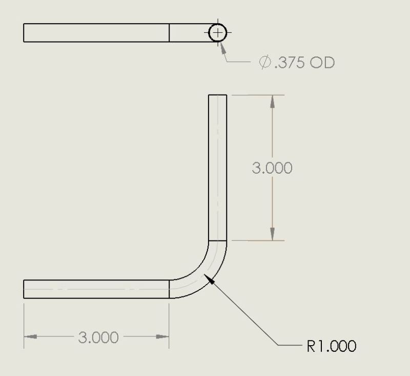

Here's an example of the kind of madness I get to deal with. This is a piece of "3/8ths ACR copper" (no specific metallurgical properties noted).
It gets the point across, but when quality receives it and checks the dimensions it becomes a real headache.

You have to admit that parts that meet the print would work great. It's just that there are so many other parts that don't meet the print that would also work pretty well that suggest to people some cost reductions are possible.
I especially like the straight length dimension, because locating that transition from bend to straight is very clear.
I guess they should mention if it's annealed or drawn; also mentioning ASTM B280, unless you're not in the US.
Photoshop would make as quick work of that as an eraser on a pencil drawing. Faster than having to staple a bunch of stuff together. Even if you just pasted a note .xxx = +/-.100, that would take care of a lot of it.

That has to be one of the worst dimensioned drawings I've ever seen (although it is physically possible to make, unlike some of the stuff we have had to fix when we acquired outside product lines). I'd fire who ever made it and anyone else in the approval/release chain. That's probably not going to happen plus you would then have to find competent people to replace them. I personally like the radius dimension to the centerline, good luck measuring that. While you can handle this with concessions or deviations, etc. that just adds more paperwork and opportunities for mistakes. I would start submitting engineering change requests one by one as each of these come up. I don't care what CAD system they are in, the drawing is a defining contract and needs to be correct.
One proactive thing you could try is getting the engineering department to change their part, assembly and drawing templates to make the default tolerances big enough to provide rational tolerances for non-critical parts like this. I'm a big advocate for large default tolerances.
