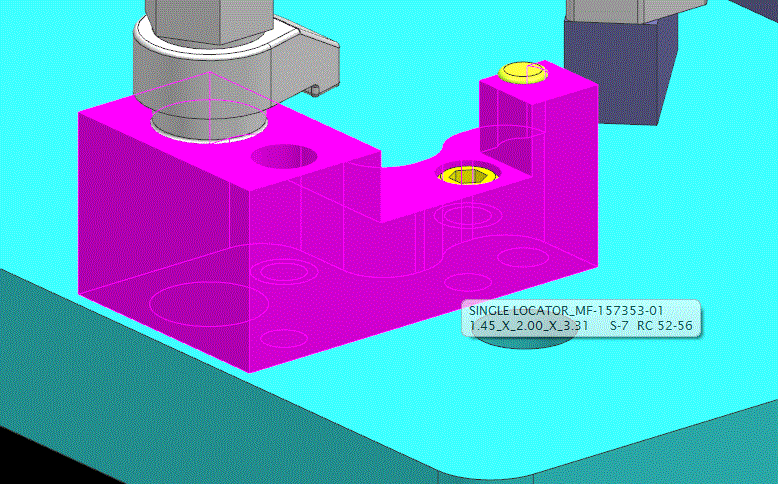

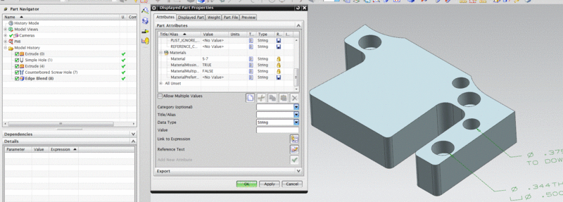

This Journal find has been beneficial, but there is one change I would like to make.
How do I get this code to automatically set attributes for each component it opens?
I have added the code below, but all it does is add these attributes to the parent/assembly file, not each child/component.
theSession.Parts.Work.SetAttribute("X-dim", bodyLengths(0).ToString("0.000"))
theSession.Parts.Work.SetAttribute("Y-dim", bodyLengths(1).ToString("0.000"))
theSession.Parts.Work.SetAttribute("Z-dim", bodyLengths(2).ToString("0.000"))
Using NX9

Do you need the bounding box aligned to the absolute coordinate system of the assembly file or the individual part file?
www.nxjournaling.com

cowski:
The bounding box would need to be aligned with the individual component's. For our designers it is standard practice to establish all component geometry off of the individual component 0,0,0 normal to X & Y if rectangular/square, and then position/constrain the component in the assembly as needed.
I have been 'working' on the code below, and so far it is working fairly well, and is doing mostly what I want, it just requires me to manually do it to every component as a work part. (I'm sure there's a much easier/efficient way to do what I have modified, but that's the best I got with my limited C++ and Excel formulas background. I'm sure you actual programmers out there will get a headache....) Ideally I would like it to run in the assembly to better insure that it can be run as one of the last steps before releasing the BOM and print to increase the accuracy and precision of our BOM to which the tool makers use to cut their stock, and make sure it is done to every component. My current fear is that this still allows the designer to run the journal, then modify a component last minute and the attributes will still show the old bounding box dims from the previous journal run, is there anyway of making it dynamic?
Another question that has arose from doing trials is that sometimes when I assign a material to a body/component the MaterialMissingAssignment locked-attribute does not always switch to FALSE, and that causes issues with my code because I want to use that as a check to make sure I am writing all the attributes I want to when the journal runs. Anybody have experience with this happening?
Your help is greatly appreciated.
One benefit of this journal is it allows me to load my assembly off of my "FULL" attribute which combines the Leaf-name, overall 3 sizes, and then the material and hardness when the component is hovered over with the cursor in the assembly window (picture below):

Quote (BBow)
Do you have multiple solid bodies in your file? If any solid body does not have a material assigned, you will get the "missing assignment" attribute. As an alternative, you might want to check that the body you selected does have a material assinged.
RE: AskBoundingBox Function
Yeah there is only one body in the component. I have attached a screenshot below, showing the part navigator tree, the part, and the properties/attributes of the file.

Thanks a lot cowski the journal works great! I have taken some of the new functionality I have been working on and got it merged together with the code you provided.
One quick question, is there a way to archive each component as it goes through the loop so it doesn't run the journal for each instance of a component? I have added a prompt to ask if the part is round if two of the bounding box dimensions are equal, and this code makes me answer the redundant question as many times as the component is in the assembly. Maybe this is a quick solution to archive the temp.Prototype.OwningPart and then skip it when it's seen again in the journal, or is there a way for a journal to recognize an overall dimension as round/round stock?
