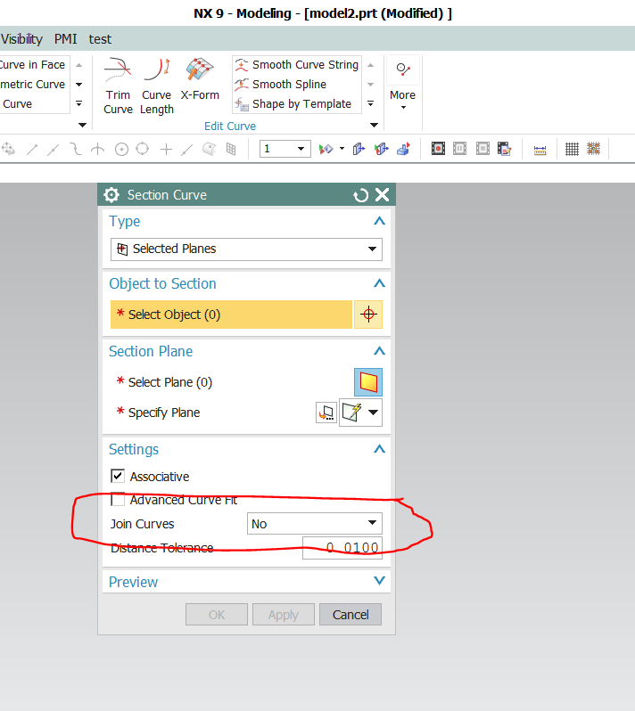

RE: NX9 section curve
Yes, the 'Section Curve' function does indeed include the 'Join' option, as shown below:
