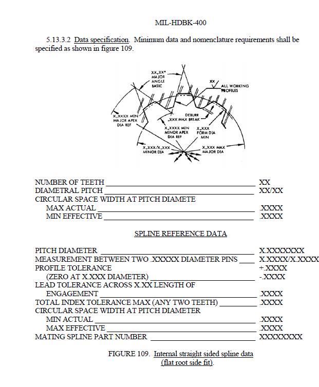

It doesn't really help the fit unless the mating teeth are free to move individually.
The symbol you have there is profile of line, which only applies to individual levels. Think of it like a deck of cards. Each card has a precise line profile, but you can fan the deck. In your case the line control is on each card, but the all-around profile is what controls the shape of the deck.
If the mating part only contacts the faces of the teeth you can use the <--> symbol and leaders and notes to indicate the extent of the face that will be controlled and use
[profile|.003|A] 16 PLACES X <--> Y.
The same technique could be used to cover the root and tip profile tolerances but with a different size of tolerance zone.
Since they use the same DRF, ([A]), they should apply simultaneously, though adding SIM REQT would help nail down any doubts. Then you fixture is one that is at the least material boundary of the profile and is MMC profile is checked by using feeler gauges that are the same as the profile tolerance size. If the GO gage fits and there isn't enough extra room for the feeler guages (flat or round pins) then the part is good.
As a practical matter I'm not sure that .003 on this small part will work so well, but that's the theory for how it could work. Another option is using zero expansion metal to cast the bore of the part and using that in an LMC boundary GO gauge.
