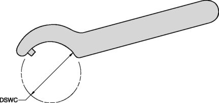

I can't see why you'd need spanner holes in an agitator shaft. However, they might be drain holes - one to vent air and one to drain liquid. The ones I'm familiar with are sealed.
