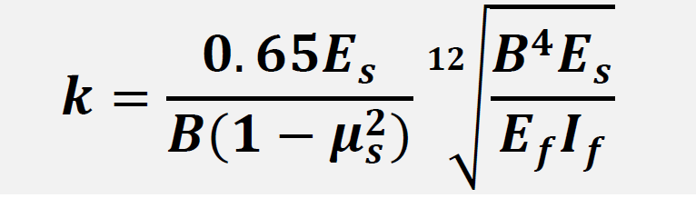

The Vesic relation is used for either sand and clay. It is the same relation as that used for vertical K in shallow foundations, but a factor 2 is applied (this is explained in the Bowles textbook). Pros are that its use is usually well accepted, is the same for all soils, includes elastic modulus of concrete and moment of inertia of the foundation.
To obtain Kh, you must multiply the above formula by 2. Es is secant elastic modulus, B is pile diameter, Ef is elastic modulus of foundation, If is moment of inertia=0.1B4 for circular pile sections. mus is Poisson secant modulus

Onengineer, actually the factor 2 is an empirical factor derived by Bowles according to whom the lateral subgrade reaction is twice the vertical subgrade reaction.
Es is a secant operational modulus, it may include degradation (dynamic) or reduction (static) schemes but it has nothing to do with the factor of 2 indicated by bowles, although very often the static reduction is taken as half the small strain E value, so I understand your reasonings.

Oneneg, usually the CPt packages produce a secant value of E (Es) which might be an E25 or E50, not Always mentioned. If it is a tangent E it should Always bear the subscript =, like E0. E derived from geophysical tests is Always an E0. Most probably you do not need to convert yor E value, since it's already a generic operational value.
Kh should reflect the operative values we believe will exist in the design situation. Designing by an E0 value will result in very high and excessively optimistic values of kh, unless we foresee almost no displacement. Since the actual behaviour of the soil is non-linear and not linear elastic, we are just adopting the most reasonable approximation here, using the secant modulus at the design strain level. The design strain level is usually unknown but can be estimated by so called degradation schemes, like the Fahey & Carter method. This in static conditions. In dynamic conditions the strain level can be estimated by tables illustrated in regulations or more accurately by seismic soil response analyses.

I have the 4th edition of Bowles which is a little different but he illustrates equations with ks as a function of depth.
Fact is that: You already have the variation with depth of Es, calculated form the CPT data and from such a curve Bowles suggests that you can calculate the non linear trend (there is an n exponent on the Z, depth value). Is such a trend really useful in your case? It may be useful when dealing with wide, homogeneous areas with relatively few tests.
The laws of variation of Kh with depth (the nh method) have been developed as a generic law extracted from databases of piles load tests. The p-y curves of Matlock-Reese and Others are such an example. The use of databases has pros and cons. I have used p-y curves to check the values I calculated from CPTs or other lab and site tests.

Oneng, Since the Es from CPT are almost certainly secant, the kh is going to be secant. I say 'almost' because I never happened to see a correlation from commercial softwares which explicitly carried the 'tangent' attribute or the E0 symbol, the subscripot 0 indicating zero strain.
Vesic formula is blind to the secant/tangent issue, so if E is secant kh is going to be secant and the other way around.
