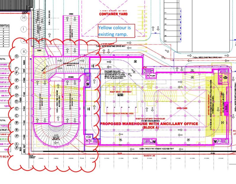

I have an existing suspended slab that needs to be topped up by concrete (attached sketch 1). It is a vehicular ramp with L.L = 15 kN/m2. I have considered 2 options.
(1) Consider the lightweight concrete topping as additional dead load and strengthen the existing slab below.
(2) Design a completely new slab (sketch 2).
But I still want explore and study one more option which is to design the concrete topping as structure & take some loadings. Is it possible?
OR
Roughen the existing slab surface so that existing slab & topping will become one slab with total depth 1150mm. Can it be?
How do guys normally do?
I will be thankful if I can have your advice or reference or example.

FYI, this project got a history and is a bit complicated. During construction we can not demolish the existing ramp one way PT slab which is connecting to the existing warehouse. We can't disturb the existing operation. So if I choose option 2, we have to construct half of the new proposed PT slab as conventional RC slab with empty PT duct inside in the meantime the vehicles will use the other half of the existing ramp with proper traffic control. After that demolish that half of the existing ramp. Vehicles will start using half of the proposed new ramp and then construct the remaining half of the new ramp. So option 2 is not as simple as option 1. Sorry if my explanation is not clear enough.
Also the topping is originally around 400mm thick. Option 1 is what we proposed and how we got this project. So my boss want to stick to option 1 (even though I prefer option 2). But later due to architect revised proposed ramp level become 800mm.
At this moment what I am trying to study is how can I utilize the capacity(L.L=15 kN/m2) of the existing ramp.

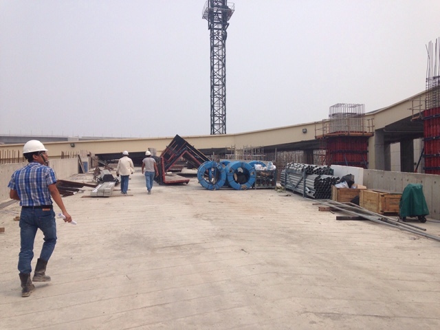

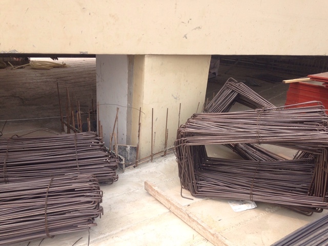

Dear All,
Thanks it was great to have your replies.
I would like to bring up this thread again just to share my proposal to client which is under construction now. You may not recall :). Please see the attached step by step construction sequence.
For the topping on the existing slab, we have decided to use Politerm Blu 300kg/m3 with a top layer of 100mm conventional concrete with reinforcement mesh.
http://files.engineering.com/getfile.aspx?folder=8...
