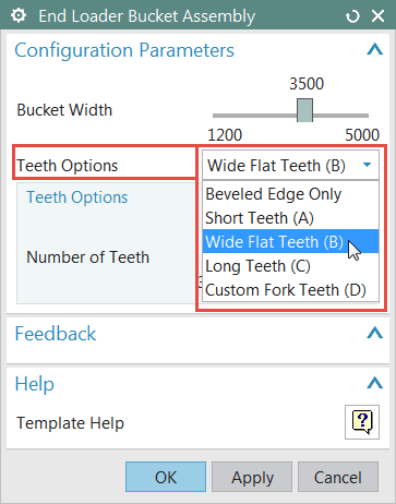

If you're trying to do more dynamic editing of design assemblies, the Part Families are just not the right tool for this workflow. For this kind of workflow, you may want to consider Product Template Studio (PTS), which gives you codeless tools for wrapping UI around any part or assembly, providing a super-easy way to interact with the high-level options and parameters in a more dynamic assembly that you need to NOT be read-only.
And so again, if you can live with the suppressed components in your assembly, then Component Suppression by Expression is super-useful if the assembly in question is something that will need to be edited or changed over time. On top of this suppression, you can use PTS to make a simple UI to set all of the expressions correctly. Here's the UI for the example above, for instance:
PTS can also be used to add/remove/replace assembly components dynamically without suppression, if desired, using Visual Rules.

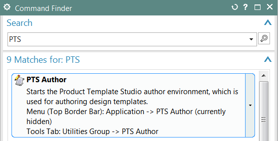

There's a great Learning Advantage course for PTS, if you want to learn more about it.
Up to NX 10, PTS runs as a Java Application outside NX. You can find it in the Windows Start menu, in the "NX Tools" folder of your NX installation.
Starting with NX 10, we've also migrated PTS inside core NX, where you can find it easiest using the Command Finder. smile
...and then see your sales rep about getting a trial license. smile
