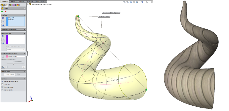

Is it possible to create an extruded, tapered helix in SW, like a ram's horn?
I got as far creating profiles and a path (see picture) but cant create the subsequent volume.

So a loft didn't work? is your largest diameter too big for the path, causing interference?

Loft wasnt working but just realised if I select central path it works fine.

Hi I resolved this by using the Loft feature with a centre line.
