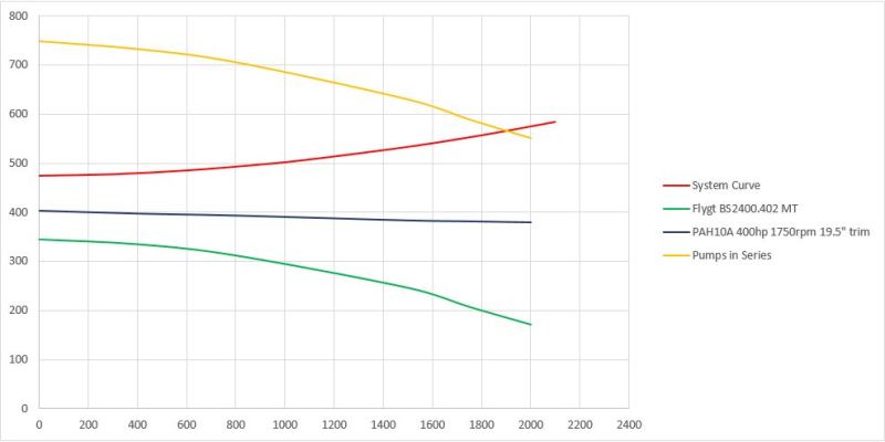

FYI, we're going with a sub at the bottom (turns out they already have a Flygt sub in place for the low pump), and a centrifugal skid-based GR Prime-Aire+ series pump at 100' elevation. at 200' elevation like the engineer designed, there isn't enough suction pressure to feed pump 2. At 100', it's just riiiight, just like my porridge.
Here's my graph if anyone is interested. I've trimmed the impeller to overshoot the flow they want. They can trim it down if they end up needing less flow, but for mine-dewatering, I can't see them wanting less. x-axis is flow (usgpm) and y-axis is pressure (feet of head). FYI, the graph below has only partial pump curves. Just so you know there is more to the right.

That is the plan. A ValMatic discharge check valve on the second staged pump. At that lift, casing pressure ratings do become important. Not to mention damage from hammer, like you mentioned. In this case, I will not be getting hammered... perhaps later.
The PAH10 curve goes a lot further to the right before a dropoff. PAH10 cap is roughly 6,000 gpm.

Then we found out that the Flygt pumps were there and still we could only get 1100 gpm with the S8C1 in series. We needed a high-head centrifugal pump to get to the flow required. PAH10 is a beauty, 400 HP electric motor...sweet!
