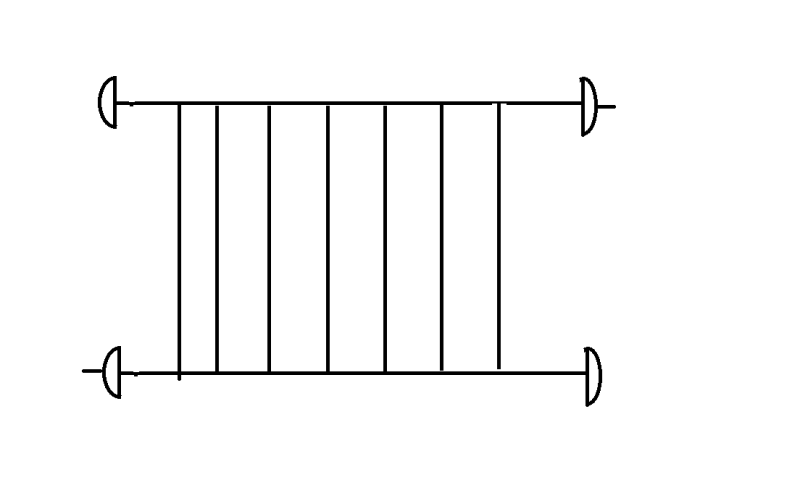

Dears,
I have pipe API 5L Gr.70 , so,
which pipe fitting specification use for this ( tee , elbows spec)
This is to construct a tank capacity of 261 m3 . The pressure inside is 90 bar (temp = 60 degree Celsius).
my pipe thickness is 15.9 is this withstand the pressure .

pipe size = 40 inches
pipe placing parallel and 1.5 meter distance
for connecting pipe i have to use elbow or 180 degree bend
in my design pipe is reduced at the bend so can you please suggest the reducer size ,

please find the attached drawing
RE: PIPE FITTING TO SELECT
Your attachments don't load. Please upload using the box at the bottom of the posting box.
Also what design code and what fluid?, liquid or gas?

Design Pressure = 90 bar
Design Temp = 60 degree celcius
Fluid = Natural Gas ( Fuel Gas )
Inside Storage we have maintain 60 degree Celsius, so there is a trace heating
This is a storage Tank(capacity 261 m3). when the system shutdown from storage tank it will supply gas to Plant.
I assume you are using pipe either because you have surplus pipe available or because you think it's less expensive than a pressure vessel? Your design conditions fall within a class 600 system. Basically, your system reminds me somewhat of a finger style slug catcher although I realize this is to store gas, not remove liquids.
< in my design pipe is reduced at the bend so can you please suggest the reducer size >
That depends on how much flow this system has to supply to the plant. The gas flows from the outlet to the plant and for the upstream segments, the gas has to travel through the various return bends. A quick hydraulic calculation should give you an idea what you are looking at. Remember as you supply gas to the plant and the pressure drops, the pressure drop across the bends as the gas is expanding and flowing out is going to increase, I don't know what your lower operating pressure range is.

There are a few crucial issues that remain unresolved so far, which to me appear to be :
a) What design code should be used for this pipe assembly to reduce wall thickness: is it B31.1, or B31.3 or B31.8 ? Is there a justification for using B31.1 -which is meant for power plant piping.
b) Why is this pipe assembly heat traced : Is it because the depressure profile during supply mode shows a low temp which is beyond the min temp limit for the downstream user? Heat tracing wont help here, you've got to add on a heater to maintain the min temp required - also keeping the pipe assembly above ground helps a bit, but hardly.
c) Current plan is to use API 5L Gr 70 : - is this good for the MDMT or lower design temp assigned for this assembly - we cannot take credit for heat tracing for this reason either. Given this is a complicated pipe assembly to simulate for the purposes of deriving min metal temp, an appropriate simulation program should be used ( not the standard version of Hysis or Pro II or similar).
