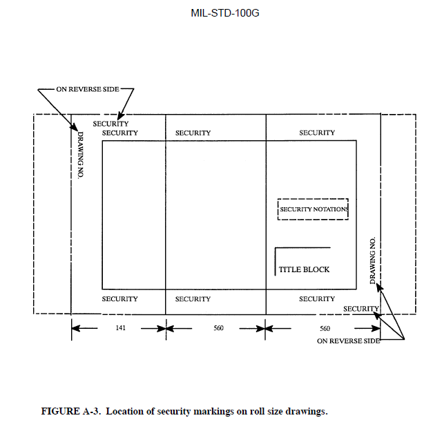

What is the intent of this number on a GM titleblock? I say it is the parent number of the drawing,
others seem to think it is the current number and rev level, only in vertical orientation.

It's a legacy thing from when hardcopies of large format drawings were stored rolled.
