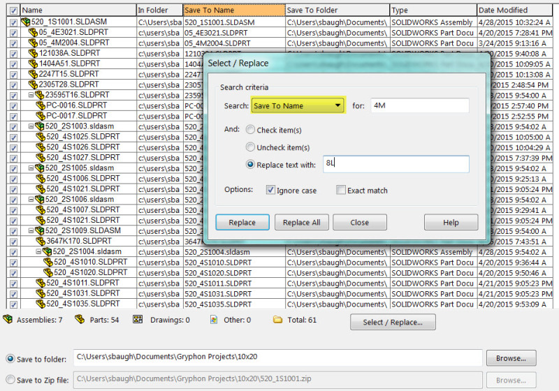

Use Solidworks Explorer and do a pack and go. Then use the "Select/Replace" to find certain characters and replace them with "XX". You can use the Search drop down to find what need to replace, uncheck, etc... it works really well after you play with some.
Do note there is a bug in the "Select and Replace" and this is especially bad if you have Letter characters in your part number. The "Ignore Case" option always is checked after you close the window. You have to deselect this otherwise it will change your letters to lowercase. Its a really PITA to fix it once this occurs.
