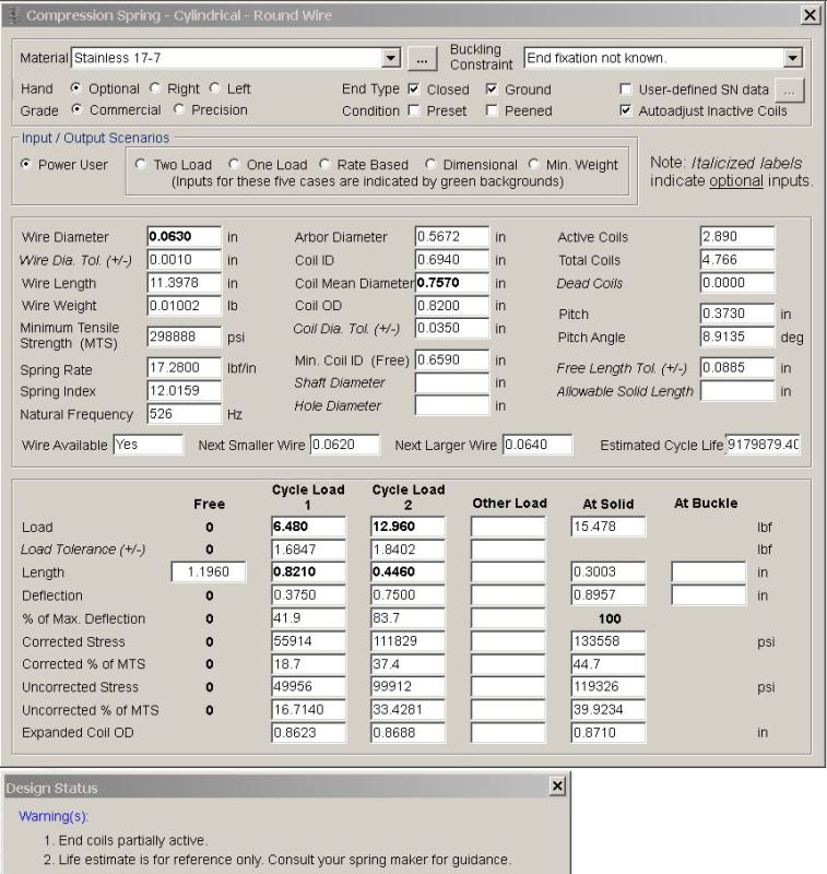

I ran that spring through ASD7 and it says the natural frequency is 526 Hz and an estimated life of 9 million cycles. I really would look into the heat treatment, if that is not right then you won't get anything like the expected life.

dgallup
To my best knowledge and experience I suspect the ASD7 program has an error in the life cycle calculation for a spring without preset (set remove, cragging). The 9 million cycles may be correct only for a spring with a heavy preset operation as the last manufacturing operation. For a spring without preset it should be around 2000 cycles.

dgallup,
Thanks for that screenshot - that natural frequency would be for a spring between two fixed plates - for my purposes I believe a fixed plate/sinusoidal drive would be more appropriate which would be equivalent to a spring of twice the length resonance wise. (or would half the frequency).
In any case, I expect broken springs when I open these after this operating cycle
