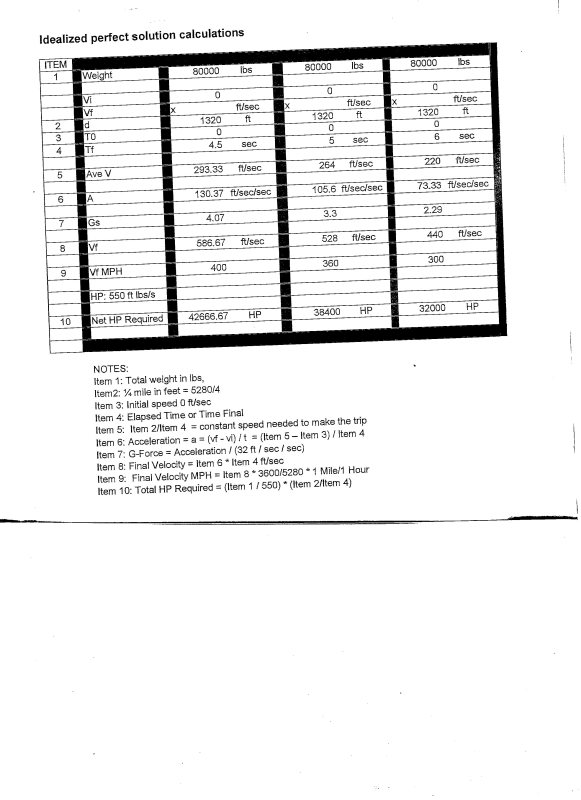

One day I was thinking about muscle cars and tractor pulls. What would you need to take a semi-tractor and turn it into a dragster? Obviously you would need a heck of a powerful engine of some kind to start with. Massaging the problem a little bit, I asked myself, "What would happen if you take an extended wheel base semi-tractor, mount a 50,000 pound flywheel cylinder and spin it up to 10,000 RPM and then pop the clutch to the drive wheels. What would happen if all that stored up energy were suddenly released?
It seemed reasonable that with enough gears, a stock semi-engine could be used to gradually bring the cylinder up to almost any speed desired. That it might be able to put a 1,000,000 potential HP into the cylinder. 1,000,000 HP / 80,000 pounds of vehicle weight would give you 125 HP to drive 1 pound of weight. I don't deal with these sort of classical physics computations on a regular basis, nor do I know that much about materials and mechanics. Would the whole thing just explode with basketball sized shrapnel flying all over the place, or could the semi-dragster be designed to handle it and shoot down down the drag strip? I don't know about you, but I'd pay good money to see a semi go from 0-200+ MPH within a quarter mile.
While this is an interesting problem, there are some serious applications I can see that could benefit from a sudden burst of energy, harnessed to do a brute-force type of event. The thing is, if you couldn't build an 80,000 lb dragster as a starting point, then these other applications probably wouldn't be feasible, either.
What do you think?

I got out some old texts and did some calculations for this idea. I think they are correct but take a look and see if you agree with them
RE: 80,000 Pound Dragster
It seems like the power curve for this is going the opposite direction, i.e. as you remove energy from the flywheel it slows down, and it would take some finesse to have a transmission that increased the rotational velocity of the wheels as the rotational velocity of the flywheel decreased.
As gruntguru noted, the max amount of power that can be effectively used at launch is limited by the traction capability of the drive tires. And it doesn't matter much how many are used. If we assume the static load radius (SLR) of the drive tires is around 21", the tires have a traction coefficient of 1.0, and the vehicle weighs 80,000 lbs, then the max torque that can be applied to all the drive tires before loss of traction is 140,000 ft-lbs. And this would not include the impulse torque spikes experienced by the drivetrain when you "...spin it up to 10,000 RPM and then pop the clutch to the drive wheels...". Designing a drivetrain capable of that amount of torque would be quite a challenge. Here's a white paper on a similar situation.

I broke down and did some calculations. I have attached the spread sheet (*.xls). You can check the math.
I found out if you take a single steel disk with a radius of 2 feet and a width of 1 foot, spin it up to 5,000 RPM you get a potential of about 35,450 HP
I also found out you need in excess of 32,000 HP to move 80,000 lbs a quarter mile in less then 6 seconds.
So, theoretically it is possible to create an 80,000 lb dragster that will do a quarter mile in under 6 seconds.
But with these kind of forces you have to be concerned about what kind of materials could take this kind of stress. So now it is a design problem. I was thinking if the flywheel was mounted on a tempered steel shaft 6 inches square, if that might take the stress.
I was also wondering if instead of U-Joints, each drive wheel is directly connected to the flywheel axel. There are no joints. Could it now take the stress? The drive wheels are off the ground as the flywheel is spun up. Popping the clutch in this case consists of slamming the drive wheels to the pavement simultaneously, or in some sort sequence. Instead of one big flywheel, and one set of drive wheels, 2, 3, or 4 drive shafts with integrated flywheels were utilized. Spinning up the flywheels would use conventional gears and joints powered by the truck engine. Some of drive shafts are identically geared for initial clutch pop. After the first one or two drive shafts are dropped, then the last one or two are geared higher (bigger tires).
As I said, this problem is a simple proof of concept for something more awesome (maybe).

I think your required horsepower is less than 1/2 of what's actually required; I get something more like 87000 hp.
Your example disk weighs nearly 6000 lb, all by itself. When you add in the the structure required to hold and constrain that large a mass, you're probably adding 20000 lb to the vehicle. I think you'll find that the engine required to crank the flywheel up to speed in any sort of useful time will be gigantic. Getting 87000 hp is a nontrivial. As an FYI, the nuclear power plant for a Ohio-class ballistic missile submarine with 170-m length is rated for 60000 SHP.

I ran your 80,000lb, 32,000hp, AWD drag truck concept in HP Wizard and got the result below. I used a tire traction coefficient of 1.0. It gave a 9.9sec 1/4 mile time at 179mph. This includes the effects of aero drag which I don't think your spreadsheet calculation did.

tbuelna's results bear some consideration. That analysis uses 1g as the maximum acceleration, but to achieve 6 s 1/4 mile time requires 2.28g acceleration. This will require chewing up way more energy than would be required for a <1-g acceleration
The ending KE is 326 MJ, which, for a gasoline car would mean that about 7 kg of gas -->2.25 gal. So this would work out to a mileage of about 0.11 mpg

With friction coefficient = 1.0 "It gave a 9.9sec 1/4 mile time at 179mph. "

Yah, that's actually pretty amazing; the fastest 1/4 mile time results in about 6.4-g acceleration.

That was a tire traction coefficient = 1.0. The reason drag cars were able to achieve acceleration rates far beyond 1g was primarily due to help from aerodynamic downforce. A modern top fuel car probably produces over 15,000lbf of aero downforce at top speed, or around 6.5x the car's race weight.
If it matters, I re-ran the 80,000lb 32,000hp drag truck performance in HP Wizard using tire and aero lift/drag characteristics typical of a top fuel dragster and got the result shown below. You'll note that HP Wizard lists a default traction coefficient value of 4.0 for a drag race slick. But in reality I doubt this tire would be suitable for use with the 80,000lb truck described, as the typical top fuel dragster only weighs 2250lbs.
