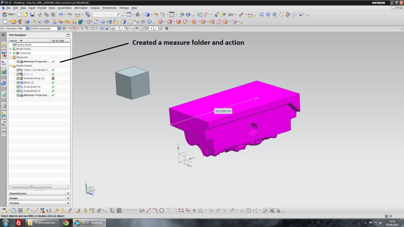

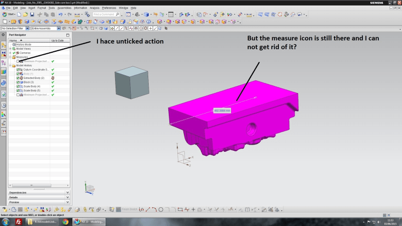

Hi I am having a problem with measuring solids and the measure icon stays on screen and I can not get rid of it does anyone else have this problem and knows how to turn it off?

Press F5 ( Or "refresh" in the View popup)

F5 is the right answer here.
These measurement annotations remain visible until a screen refresh, which can happen a few different ways automatically, and with F5 immediately. smile
