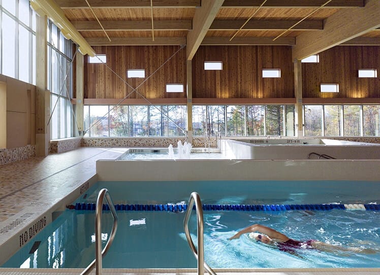

Not sure how much it helps but the university were I got my BS finished this monstrous waste of money the year before I graduated:
UMaine does a lot of research with engineering composites, mostly glulam timbers and glulams with fiber reinforced tension faces. I imagine to show this off they had the architect of the "New Balance Student Recreation Center" (eye-roll) use a lot of wood glulam beams.
Anyway, it has a very large span over the pools done in all wood and the basketball courts have a suspended running track. As the framing for the track is hidden it could be steel or wood. Overall it uses a lot of engineered lumber and, having used it, would rate it as probably the least vibrating gym I've been in.
Also, if you want, try getting in contact with Dr. Habib Dagher, P.E. http://composites.umaine.edu/contact-us/faculty-an... He's probably close to the forefront of composite wood beam design and could at least point you in a good direction.
