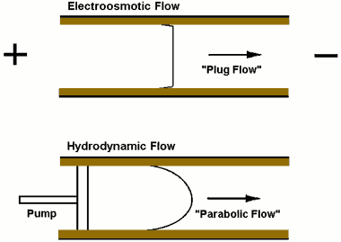

Im working in the field of High Pressure Liquid Chromatography (HPLC) where our "tubes" are filled with semi-permiable particles and our plugs are parabolic. Changing the liquid is unfortuneltly not an option (sorry Compositepro). So what I understand from you is that I have no chance of changing the velocity distribution in the tube by going with another geometry (i.e conical)?
There is a closely related field where the flow is electroosmoticly driven. They have ionised liquid and charged wall surface (called Capillary Electrophoresis). They have "plug flow" due to the entire plug experiencing an electric field.
Perhaps my lack of knowledge in your domain is making it hard for me to correctly describe the problem. Apologies for that. I have attached a figure, my case on the bottom, the desired case on top.

Are you pushing fluid with a syringe, as shown in the bottom figure? Is the issue then not the flow profile, but the shape of the meniscus? You could try changing the chemistry (surface energy) of the tube wall to get the wetting angle of the fluid as close to 90 degrees as possible...
Otherwise, the only way to have a flat flow profile in normal fluid flow is to consider very high Reynold's numbers for short distances downstream from the entry.

If you using a plunger, shape the top of the plunger with a recess so the "slug" of the moving mass of liquid ahead of the plug approximates a flatter surface. With a fluid getting pushed into a second fluid, it will never be "flat" as drawn.
If the fluid is being pushed into a vacuum, then you'd have a chance if you can exactly predict the front "curve" of the fluid using a flat-surface plunger. Then make the recess to flatten-out the curve.
