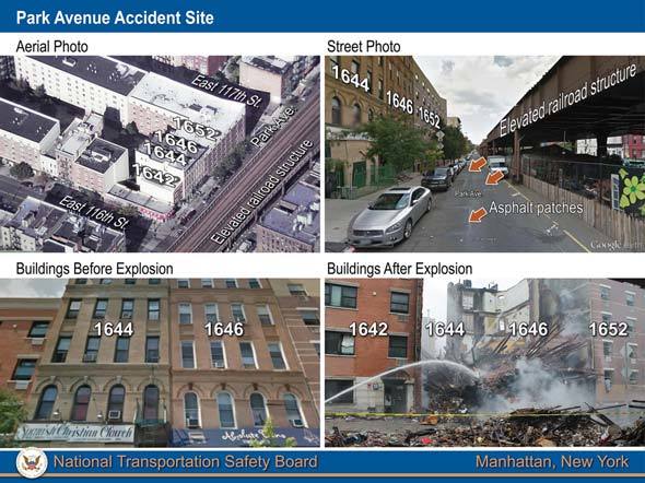

It is interesting that while many, including up into the hallowed halls of Congress and some special interest industry, were quick to blame e.g. some gray cast iron pipes with ancient joining technology (that had incidentally provided at least some level of service since the time of Grover Cleveland) for the unfortunate, deadly and initially well-publicized East Harlem gas pipeline blast last March, some information that has dribbled out in the more than a year since have indicated maybe, "Not so fast...."
The article e.g. at http://www.wsj.com/articles/probe-into-east-harlem... e.g. says there may well have been some involvement with separation of a "T-shaped connector" in a relatively brand new (~3 years old) plastic pipe and service installation near the scene. While apparently some very small leaks were also found in the surrounding main area, it will be interesting to see (the final report may still not be out in this matter after more than a year!) what exactly is involved here, as electrofusion is in general attempted not only in socket type, but also for lateral/service connections.
In this regard, it appears from at least the preliminary "Operations Group Factual Report" this year, I also happened to see not long ago at http://puc.sd.gov/commission/PSOT/2015/presentatio... , that the East Harlem "T-shaped connector" that separated from the main had in fact been "electrofused" in at least some extent to the plastic main. I had noticed this reported separation was described by the third-party gas pipeline safety consultant in the WSJ report as, "This is going to leak a lot of gas,"

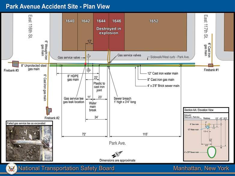

Federal investigators said a poorly welded joint in a Con Edison gas line and a break in an old city sewer line were the likely causes of the blast.
They say the joint’s weakness was exposed when the soil beneath it was undermined by the sewer break.
RE: Butt Fusion vs Electro Fusion
I would have included within the recommendations to prevent this from happening in future to provide adequate support, maybe something like a steel pipe half casing laid under the plastic pipe, when spanning sewer pipes, or any area where soil erosion and loss of natural support may occur.

The gas main actually ran parallel to the sewer pipe. The cause of the blast; from improper training, installation, emergency response, utility operations, you name it. Any number of separate acts could have prevented the explosion or prevented the loss of life. For example, the sewer had a major leak for 8 years that was known to the City and not repaired. The gas smell was observed the night before and nobody reported it. The Street has a major failure and nobody investigated further. The piping was never tested.
Events like this should not be occurring. The report should also have called for more spending on infrastructure. There was a 100 year old water main and a brick sewer.
