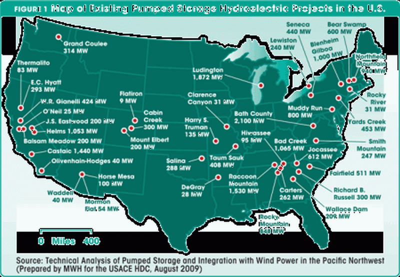

Your proposal is variation on "Pumped Storage" which has been discussed in reason years. In its traditional form pumped storage uses reversible hydraulic turbines operated as electric motors to pump water from the discharge back into the reservoir. The electric power to do this comes from base-loaded generating stations during off-peak hours when to maintain efficient operation coal & nuclear stations have excess electrical output available. Here is a map of many existing large commercial pumped storage stations:
Quote (dwbarlow)
Why are we still relying of coal and nuclear generation plants for electricity?
In three words... cost, availability, reliability. In operation, coal and nuclear can efficiently provide large, continuous amounts of electric power, 24/7, for months on end. They are typically the first choice for an electric utility's base-loaded stations. Hydro can provide some base-load power using the mandatory minimum discharge of water required to keep streams & rivers from drying up. However, the majority of hydro power is far to valuable to "waste" for base-load. A hydro station can make a "cold start" in a very few minutes and is best used for peaking-power, typically a few hours per day, often during extreme weather. In comparison, it can take the better part of day to make a cold-start of a coal or nuclear plant.
Most renewable energy, such as wind and solar, are ideal for load-following. Use these sources to directly feed power to the electrical grid when their "fuel" is available, regardless of the time of day.
The amount of electrical power used in a country such as the USA is staggering. There are nowhere near enough undeveloped hydroelectric sites to make even a dent in the power demands. When you couple this with the environmental & social impact of creating a new hydroelectric reservoir there is really little reason to actively pursue large scale hydro power. Money spent on this effort could be spent much more cost effectively on research, development, and deployment of wind, solar, geothermal, natural gas, etc. power generation. Over many decades, it may be possible to phase out coal as a major electrical power source, but it will not happen soon.

The structural issues with dams should be distinguished from the concept of pumped storage.
The pumped storage generating scheme in Bath County, Virginia seems to work quite well. Like a giant storage battery, recharged by mostly nuclear power.
http://en.wikipedia.org/wiki/Bath_County_Pumped_St...

RE: GENERATION OF UNLIMITED ELECTRICAL POWER WITHOUT USING HYDRO-CARBONS OR NUCLEAR ENERGY
Hokie66,
The Taum Sauk pumped storage system was quite successful too until the operator overfilled it, then it was realized there was no overfill spillway and the dam was incorrectly constructed.
