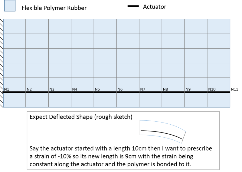

I appreciate you DrBwts for keeping up with this and trying to help out. I think maybe I have not explained the problem well enough. Attached is figure of a very simplified case of a single actuator. As you can see as the actuator changes length (strains) the structure bends, but I don't know its final shape, that is actually what I am trying to figure out.
In the attached figure I have labeled some nodes along the actuator. Concerning appling BC directly to those nodes, if we look at the third element from N3 to N4. All I know is the initial distance between N3 and N4 and that there new distance between them should be less (whatever the strain I tell the actuator). I don't know the new position of N3 or N4, just the new distance between them.

How is the actuator attached? Is it bonded or are there attachment points?
RE: How to model a tendon contracting
The actuator is bonded/cast into the polymer. Additionally in the ends it is anchored. I think the valid assumption is the the polymer is perfectly bonded to it and they strain together. The actuator can directly control its own strain up to 25% length change.
Really this all just boils down to finding a way to directly-control/prescribe/define the axial strain in a line element even through the line element may bend with the structure (Note this would be a truss element so there is zero bending stiffness).

Your problem sounds similar to what I have used in the past to model post tensioning of reinforcement. An easy way of obtaining a solution is to use reduction of temperature. Calculate what change in temperature you require for a given section and coefficient of thermal expansion, to give you the appropriate contraction in your element.
