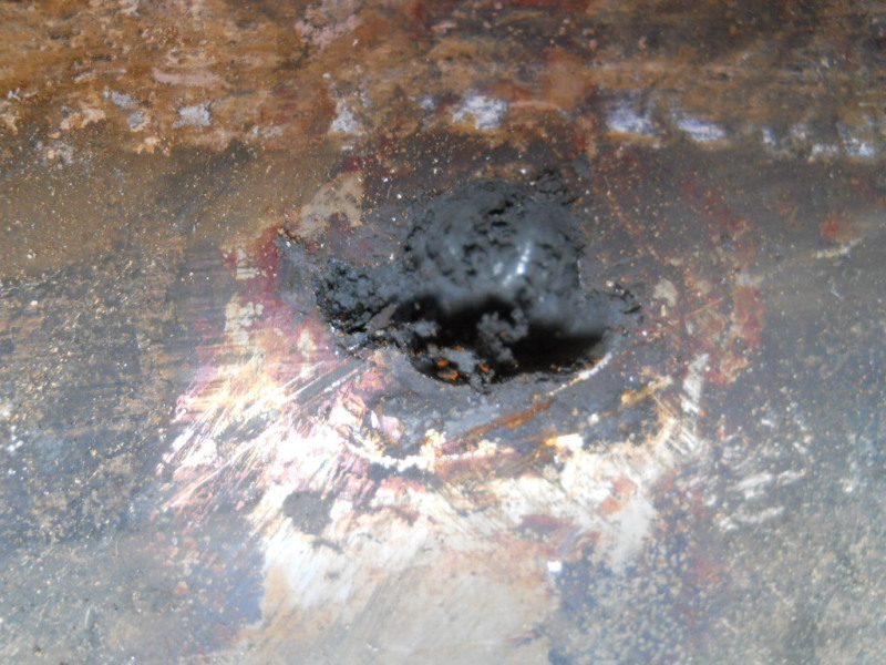

I am new to this site and could really use some information. I have two shafts 130mm with heavy pitting that I need to have resurfaced and machined. I am probably not using the correct terminology please bear with me. Some of the pitting is 1/2" deep but I have heard that the shafts can have a new surface applied through a welding process and machining. Is there a depth of corrosion that decides when it is time to scrap the shafts? The yacht is in Miami,FL, if someone knows of a reputable machine shop that can handle this type of job please let me know. Or if I am missing important information about the process I am all ears. The spots in question are between two bearings. Please see the attachment for a picture of the corrosion.

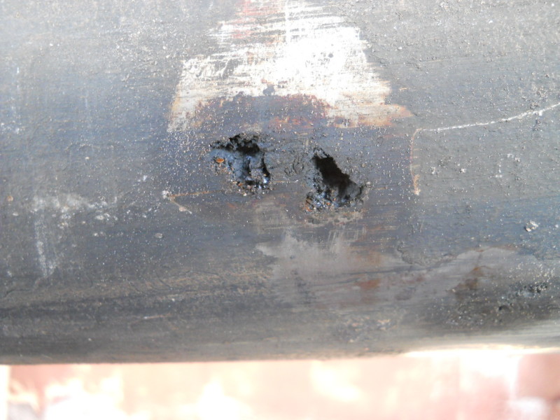

Not sure why the pics didn't upload. Will try again. Behind the packing gland is the first bearing then 4 ft further is the stern tube bearing. It seems as though the bearings are trapping water. Research indicates in time the salinity increases as well as oxidation lowering the O2 content accelerating the corrosion process. Is that correct? Is there a formula for distance between bearings for a 130mm shaft? I have never seen bearings so close together and that is where the heavy pitting has taken place. I also noticed the first bearing is worn substantially more than the other 3. I see your location is Pembroke pines do you do SS shaft work there?

Wow, that is nasty. I can't say I've ever seen corrosion that highly localized and deep. Given that, I wouldn't trust the remainder of the shafts.

The shaft shown in the photos looks like it already had some weld repairs performed on it. And given the current state of the shaft I can't imagine it would be cost effective to try to salvage it versus machining a new one.
RE: 150 ft yacht with 130mm shafts. Problems with shafts.
In Italy they supposedly replaced the shafts July 2012 for the same issue. Unless they told the owner they were new shafts and machined the old ones? What do you see that makes you think they have been machined before?
First determine the alloy. There are NDE Labs in the area that can perform XRF PMI (Positive Material Identification. I also believe that at least one lab in S. Florida can perform PMI with optical emission spectroscopy. Then a more corrosion resistant material can be selected or additional operating parameters (fresh water injection proposal) can be installed. From its past history, localized welding repair with matching weld filler metals or more corrosion resistant weld filler metals will not provide increased service life.

Guys thanks for leading me to Brian at Aquamet, it appears the Italians put in the 17 instead of the 22HD or 25. This is why the magnet sticks to it like it does the hull plating. There is Cathodic protection and monitoring which is within the normal range. I will be adding a potable water flush to keep the salinity down in the space and replace the shafts with a higher quality. Thanks for all of the great advice and input greatly appreciated.

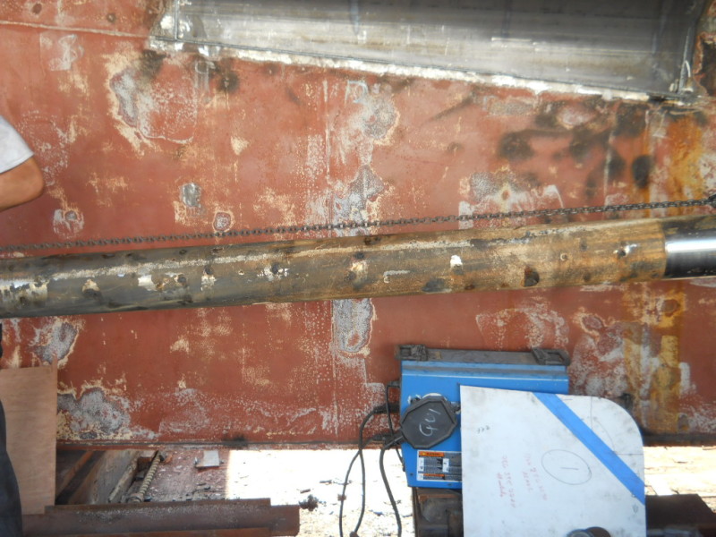

In the first picture posted above you can see a MIG welder sitting below the corroded prop shaft. I hope they weren't using the MIG welder to rework the corroded sections of the shaft in-place. 17-4 stainless can readily be welded, but the shaft would need to be heat-treated after welding, re-machined/straightened, and balanced.
tbuelna,
Looks more like an SMAW welder to me.
What makes you think it is GMAW ?

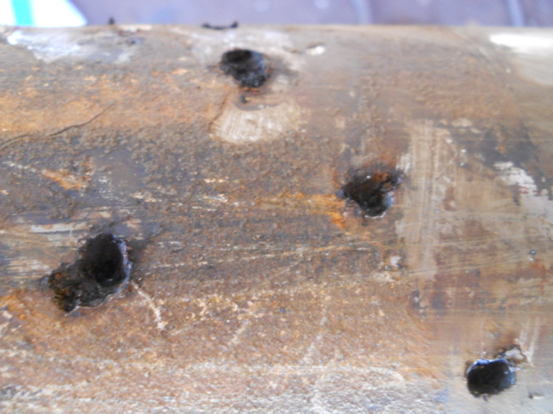

Very observant guys. The welding machine is being used for hull plating replacement. The shafts are at F&J Propeller in Miami. They will be machining and welding the deep intrusions and buffing back down on non bearing surface. See attached pictures of test area. They will be doing an overlay on the bearing and packing surface. They have a 50 ton press for straightening the shafts. Thanks again for all of the input.

Definitely a Miller machine based on the blue paint. The only reason I assumed it was not a stick welder is because there are three cables attached to the machine face.
Also, if you look at the second photo in the post above from captstaats, you can clearly see the remnants of a piece of errant MIG wire just to the upper left of the weld repair.

Was there any NDT performed? As I see the repair, I wouldn't OK it. I'd like a bit more certainty than just a visual inspection on those shafts. I would also be hesitant on using GMAW/MIG for this type or repair.
A piece of wire and a lot of oxidation.
And what about all of the little pits? Those need to be done away with also.
What material is being used as weld filler?
Looking at the boat specs it says that the engines are 750hp. That makes these very low strength shafts.
Which is good news, since the repairs will not be highly stressed.
