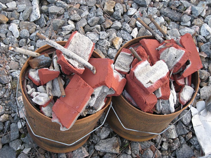

You mentioned it was found with brick and other debris. Thermite welding molds sometimes look like brick after they are broken up.

Hah, Thermite Welding Mold - that might explain this fragment I picked up the first time we saw this kind of material. Didn't look like any brick I'd ever seen.

PJ...quite possibly a fragment of a mold. Since it was dumped there from another location, it is likely only a small fragment.

The thermite molds are manufactured from ceramics, not thermite. The thermite would be a coating on the mold.

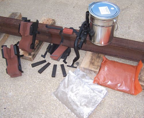

A pic of the thermite welding the LIRR was doing, would have been done there, too. Link
I know the aluminum concentration is wrong for straight up thermite powder, but I keep coming back to the fact that Orgo-Thermite supplements aluminum its powder with maganese and vanadium. Link
I didn't take a picture, but it looks like this Vanadium Pentoxide Link

Oh, wait, it looked just like this:
