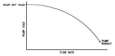

To fully understand your application, you should post a pump performance curve.
This appears to be runout of the pump. Your pump is pumping at too great of a capacity because there is low resistance (differential pressure) to flow.
For a given centrifugal pump, the flow rate through the pump is dependent upon the differential pressure or head developed by the pump. The lower the pump head, the higher the flow rate. A specific pump has a curve of pump flow rate versus pump head called a pump performance curve. After a pump is installed in a system, it is usually tested to ensure that the flow rate and head of the pump are within the required pump curve specification. A typical centrifugal pump characteristic curve is shown below.
There are several terms associated with the pump performance curve that must be defined. Shutoff head is the maximum head that can be developed by a centrifugal pump operating at a set speed. Pump runout is the maximum flow that can be developed by a centrifugal pump without damaging the pump. Centrifugal pumps must be designed and operated to be protected from the conditions of pump runout or operating at shutoff head.
The pump may not have enough HP to pump at the rate that you are pumping.
Post the pump performance curve to confirm.

I do have the pump performance curve and it is not near the shut-off head, instead as LittleInch mentioned, it is going off the curve to the right side (getting into low efficiency)Pump Runout. We need to add head into our system and wanted to make sure that the two bends were not working against the system. We need more head in our system, do you think by adding an orifice block at the discharge end (after the bends) would drive us back to healthy pump operating points? It is currently running ~1' above the pump runout. (I will try to post the performance curve ASAP.)

Would love to see the pump curve....
RE: Pump Run Problems
That's an interesting pump. I haven't seen many where power goes down at flow goes up. Given the high efficiency shown you really must be operating at virtually zero head. Try an orifice and see what happens.
